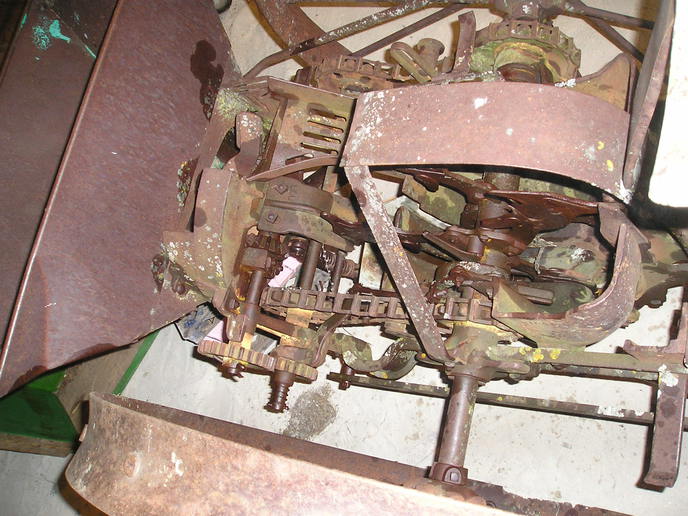

bigardo
01-08-2019 06:34:18
Report to Moderator
 Re: TO30 Steering Box to Bottom Cover Gasket Needed in reply to bigardo, 01-08-2019 06:16:39
[img]https://forums.yesterdaystractors.com/photos/mvphoto29364.jpg[/img]
[Log in to Reply]  [No Email]
bigardo
01-08-2019 06:31:48
Report to Moderator
Part #23, TO-3558-A. I am in Macomb, MI
[img]https://forums.yesterdaystractors.com/photos/mvphoto29363.jpg[/img]
