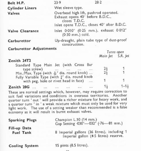

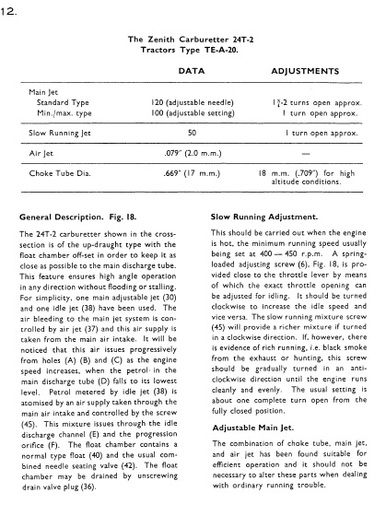

Now that I have got my 1949 TEA-20 firing up and running somewhat I am ready to tune it up a little bit. It has the Zenith 24-T2 carburettor on it. I would like to set all the screws back to stock standard first as I'm not sure what the previous owner had them set too and no doubt some bits and pieces may have moved a bit during the process of taking it off and cleaning it. The only information I've been able to find is that the main jet should be 2 full turns from the closed position and I'm not even sure that this is correct. Any information in this area would be greatly appreciated.

Two turns CCW is about right, with 1 3/4 to 2 1/4 being the usable range. Running too lean, 1 3/4, for long periods can be hard on valves, although it would use less fuel. CW will lean the mixture.
The idle is adjusted first to about one turn CCW. CW will richen the mixture.
Info I have used since 1975:
Info from original Ferguson Service manual:

My own fault for not making the carburettor adjustments once it was running on the previous settings. I can barely get a a pop out if the engine trying to start it now. I reset the settings to 'Standard' e.g. 1 turn open for throttle idle screw, 1 turn open for slow running screw & 2 turns open for the main adjustable jet. It was interesting to note that when i was resetting the screws that they all seemed to be unscrewed quite far from standard settings. Anyhow it won't start now and I have run the battery dead flat trying various other settings in the process. I should note my adjustable main jet has the knurled knob with a small round point on it. It appears that there is a few settings are standard depending on the main jet on your carburettor and I have got some conflicting information from various sources including a few publications. You would think I could get it to fire and run for at least a few seconds when i had it running and idling somewhat o.k. before making the adjustments. All i get is a slight pop from the engine and then it stops and the starter motor makes a big wind down sounds (kind of like a bomber siren from WW2).
