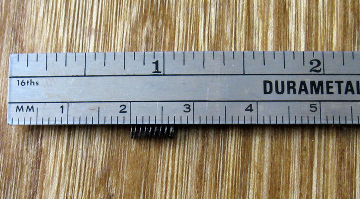

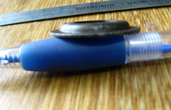

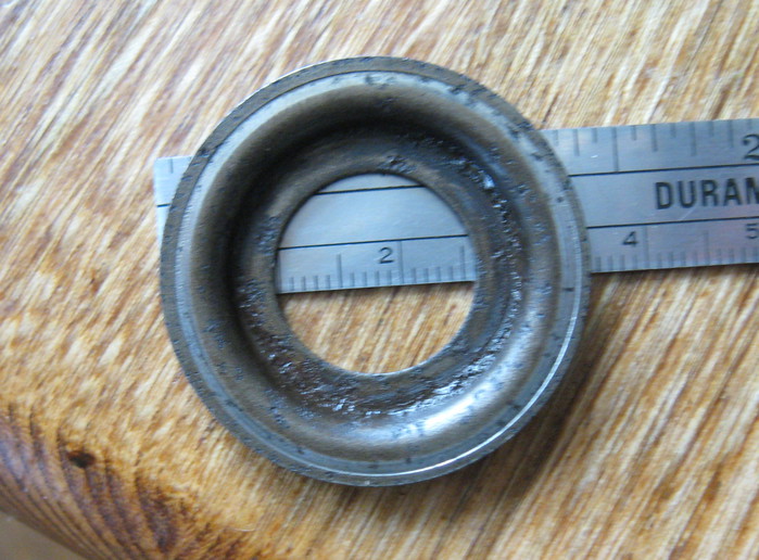

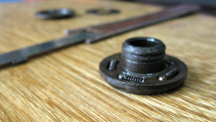

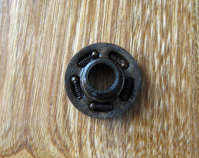

The suffix EVR at the end of the serial number indicates that this engine has Exhaust Valve Rotators. I have the same suffix on my engine and broke a valve spring several years ago. While taking off the valve cover I noticed small ball bearings laying in the oil on top of the head. I picked up all the parts but could find nothing in the manual about them. I contacted John(UK) and he was aware that in the late year engines (1954) some were equipped with exhaust valve rotators as a test for the new 35 engine. He was not aware of the engine suffix but found out about it through research. He requested that I take photos and measurements which I did and sent them to him. He tried, unsuccessfully , to locate replacement parts so I managed to put the one I had back together and reinstalled it. Still working OK.
If you do break a valve spring or have to remove the valves be careful you do not lose the tiny ball bearings as they could possibly drop down the pushrod holes.

I cannot find the email I sent to John with the exact measurements etc. but the photos will give you an idea of what to expect. John tried all possible suppliers in US, Europe and Austrailia with no luck.
Hope this helps.

Further info: John(UK) also said that the rotators were not really needed and the valve spring could be replaced as usual.
