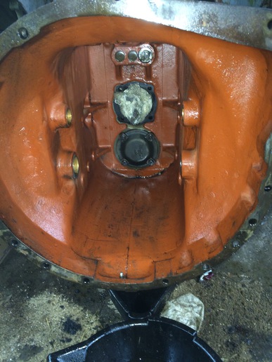

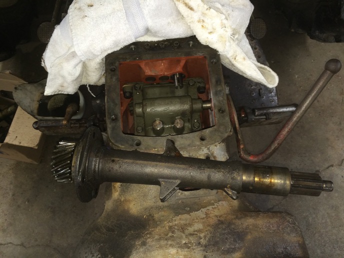

In case there's interest here's a pictorial of the Sherman install that consumed a bit of time over the past few days -
I have a TO30 that needed engine work that necessitated pulling the engine - I had scored an Sherman combination 3-4 years ago off of eBay and had cleaned it up, inspected, and procured a few minor items (shims and gaskets and a seal) in case this day would ever come -
engine pulled, I went ahead and removed the steering pedestal, starter mechanism, brake and clutch cross shafts, and input shaft to clear the area - nasty oily (leaking rear main seal on the engine) - I later went ahead and pulled the shift cover so I could see what was going on with the preload on the bearing
third party image
a quart of kerosene and half a can of brake cleaner later and the area was fit to work in

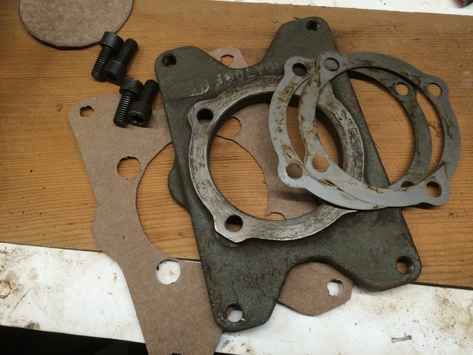

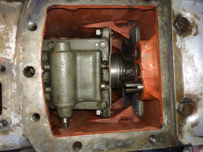

The mounting flange and shims and gasket - to make a long story short, I didn't need the shims and I also made a gasket out of thin material to get the input shaft acceptably close to the bearing
third party image

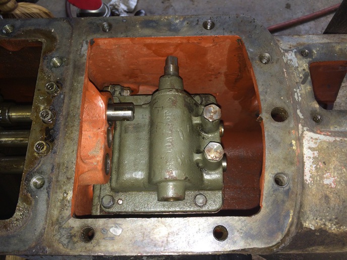

flange installed and Sherman about to be bolted into position third party image

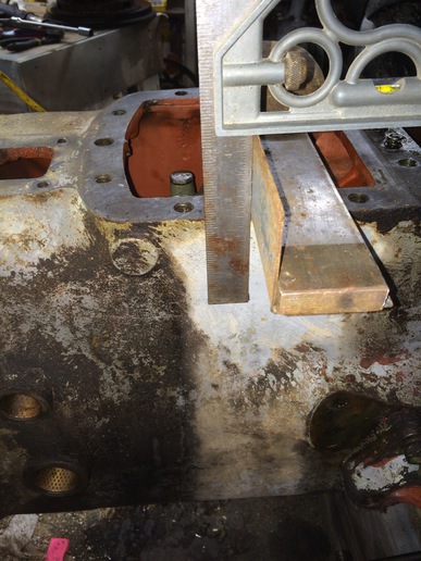

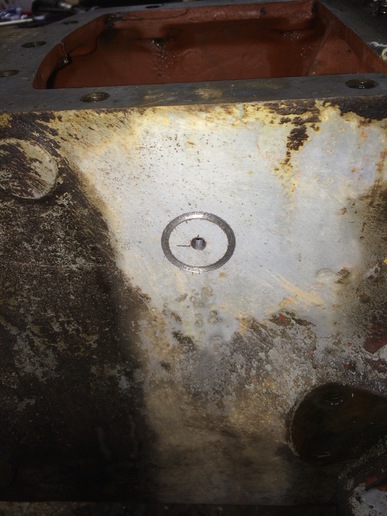

after a couple of times in and out I tightened things so to locate the shifter hole - I was worried about this aspect, large holes in heavy metal is a weak point in my skill set -
third party image
I used a bit of angle iron and machinist square to locate the center of the hole
third party image

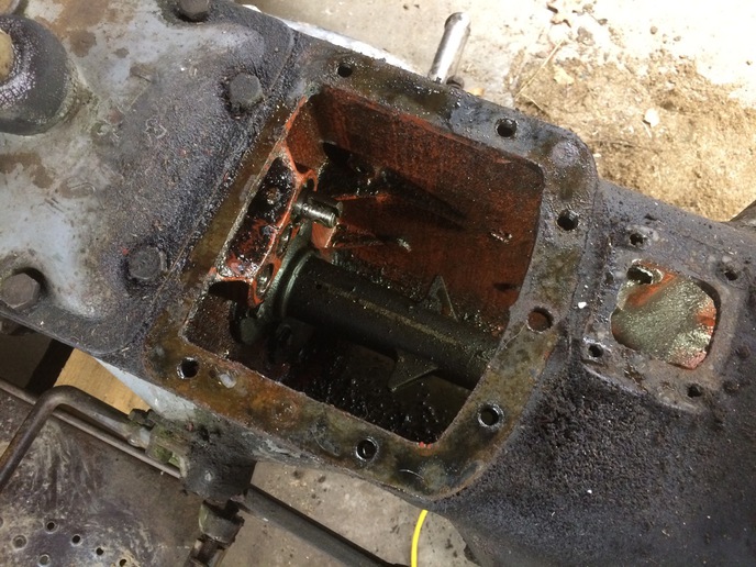

removed the transmission again and drilled a pilot hole and then went with a bimetal hole saw
third party image

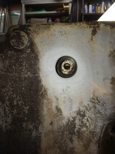

I was pleasantly surprised at how straightforward/easy it was - I cleaned up the hole with a grinder, shot a bit of gray primer on the area and put the Sherman back in position - I'm satisfied with the result
third party image
for future reference, this hole is centered at 2-7/16" down from the pedestal machined surface and 14-1/8" forward of the transmission flange
filled with GL-1, new seal on the input shaft, shifter in position - the Sherman and the piece it replaced -
third party image
