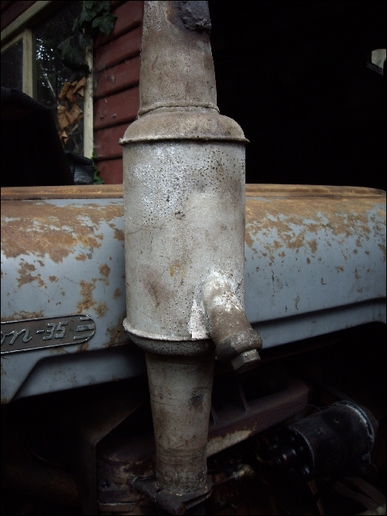

The Australian made spark arresting muffler fitted to my FE35 Grey and Gold has made a mess of the bonnet and emblem .
third party image
The problem occurs due to wobble in the front pivot joints , some tractors' bonnets wobble more than others . You can play around by packing the joint on the rhs with washers to give slightly greater clearance on that side .
