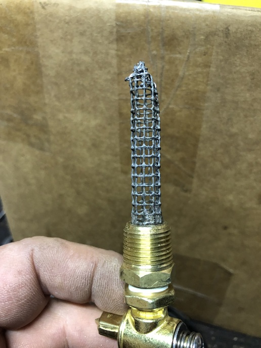

Masseyharrisnut
11-17-2023 18:08:14
Report to Moderator
 Re: Farmall 350 Fuel Tank Screen Question in reply to Bill VA, 11-17-2023 17:31:54
Here is a picture of the ones I make with tanks that are not real clean. Works great. Third Party Image

Duner Wi
11-18-2023 04:50:42
Report to Moderator
 Re: Farmall 350 Fuel Tank Screen Question in reply to Masseyharrisnut, 11-17-2023 18:08:14
I do the same but with fine screen from n old AT transmission filter.
