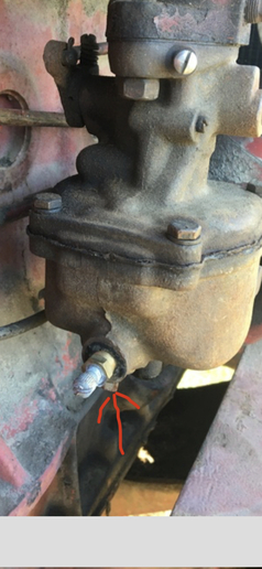

Could anyone tell me what carburetor this is on this 656 IH?
This is no ID marks or tag on the unit from what I can tell, only casting marks. Thank you for all your help!

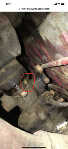

Brass tag circled in photo.

Crap that did not work right. Trying again!

international carb. the number is on that round brass tag to the left of the fuel line.

I would describe the location of the round brass tag as by the back nut bolting the carb to the manifold. The proper term for the area is the ..mounting flange..

What have you done to diagnose the carburetor? Do you know if gas is getting into it? There is a small square headed plug on the bottom, see picture. You need to pull that out and see if gas flows out of there!! Should maintain a steady stream and not slow to the point that the stream has gaps in it. FYI, the fitting that screws into the carb that the gas line attaches to has a fine screen on it inside the carb. If there is not an acceptable flow then check there. When you have the line off open the sediment bowl valve under the fuel tank. Should have good flow out of the disconnected line.

unless i am seeing things, hard to tell . thats what the tag would look like. or post that actual number u circled, or zoom in on it with a pic. cant tell or see it.
