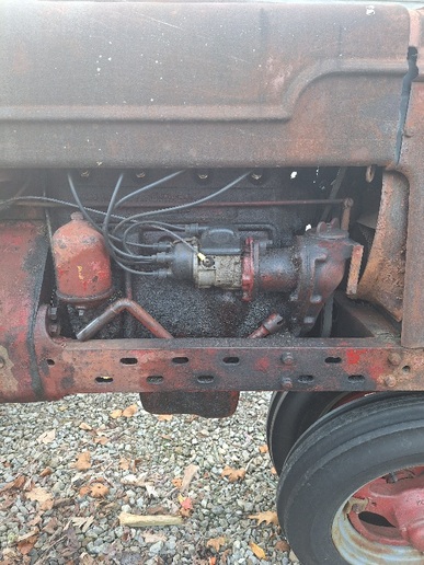

My son got an H not long ago, no battery in it. Previous Owner said it was 12v, it had a 12v batt in it. When It made it to my place no battery. Electrical system looks like my Super A, but I don't know if it is a positive or negative ground, how do I tell? Also, I have an older 12v battery that shows 7.78 output with a volt/ohm meter, will this start the tractor. One last question, it does have a hand crank, does it have to have a battery to start even with the crank? Thanks in advance of any and all help

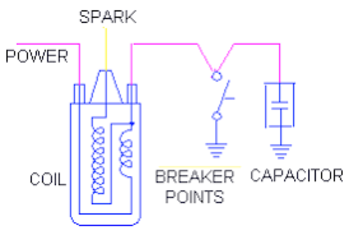

John T
10-26-2023 16:14:26
Report to Moderator
 Re: Electrical problem on a H in reply to rustred, 10-26-2023 12:47:20
Answer that. John T had an explanation I remember seeing.
This is based on my old brains recollection but NO WARRANTY so dont anyone have a calf lol it may be right it may be wrong TAKE OR LEAVE AS YOU WELL PLEASE
A coil will still produce a spark at EITHER polarity, however speaking energy wise the system operates more efficient if correct. It has to do with (thermionic emission) how it's easier (less energy wasted/expended) to emit electrons from a relatively HOTTER source (plugs electrode hanging out there in the HOTTTTT TT combustion chamber) to a relatively colder (plugs ground strap and threads into the cooled cylinder head) surface. Thats why in a radio vacuum tube there's a heater under the cathode from which electrons are emitted to the cooler plate.
NOTE she still fires at right or wrong polarity and I wonder if ones eyes might be able to note the difference BUT HEY IF ONE HAS GOOD EYESIGHT who am I to know or question what they see or claim ????? ???? Im NOT saying or judging or questioning...
A physicist friend of mine (the late Duane Larson) ran some tests and measured the voltage at which a plug fired when the coil was wired right or wrong HE FOUND THE PLUGS FIRED (current arc jumped the plug gap) AT SEVERAL THOUSAND VOLTS LESS AT THE RIGHT POLARITY versus when wrong in which case coil voltage had to raise higher (coil had to work more and wasted more heat energy) before current arc jumped the plugs gap BUT OF COURSE PLUGS STILL FIRED.
ALSO a Magneto with its North South rotating magnet fires at different polarity each time (subject to type of mag and its operation and gearing) YET PLUGS STILL FIRE
ALSO ITS MY OPINION theres a reason why coil manufacturers bother to label coil leads + and - or Battery and Distributor or whatever.
So until proven otherwise thats my story and Ima stickin to it lol IE Coil polarity matters..... ...It will still fire if wired backwards..... .....Its best and more energy efficient IF WIRED CORRECT AS LABELED..... ..How much if any difference in spark energy or what some person claims to see IM NOTTTTT SAYING
John T Again NO warranty if this is true or false, believe anything you like have a different opinion NO PROBLEM but please with all due respect to one another

Janicholson
10-26-2023 17:03:49
Report to Moderator
 Re: Electrical problem on a H in reply to John T, 10-26-2023 16:14:26
To see the polarity, put a graphite pencil point in a 1/4 inch gap between the bare plug terminal and the plug or ground. When a spark crosses the gap, it will be a pretty clean spark to the pencil, and a flair of emitted carbon and a spark to the plug/ground when correct. The internal coil connections also place the primary winding in a different relationship to the point/condenser terminal!
Third Party Image

If it has a magneto (instead of a distributor), it can be started with a hand crank. If it has a magneto, it'll more than likely be an H4 magneto. Google H4 magneto images, and if that looks exactly like what you have, then you'll know.
As for positive or negative ground, that's gonna be hard to guess at with no battery in it. It was positive ground 6v from factory, but that means nothing now unless it has been unchanged. For what it's worth, battery posts are different sizes. One being larger around than the other. You ussually can't switch them around if the clamps were only spread open just enough to get the cable off of the post. This might be a sign as to how it was. But if the clamps were spread open further than needed to remove the cables, this means nothing. As in, either cable will fit on either post. If so, your back to knowing nothing from this.
The original generator, light switch, and so on, would be indicators of an unchanged 6v positive ground system. If you know what those original parts look like.
Pictures of what you have, would be of tremendous help here. Otherwise, we can only give you limited advice.
[Log in to Reply]  [No Email]

10-25-2023 20:25:16
Report to Moderator
 Re: Electrical problem on a H in reply to GregtheDC, 10-25-2023 17:30:26
When cranking it over you will hear the impulse tripping in the mag. Plus it has a black cap on the top of it covering the coil inside. And the body is aluminium looking. The battery distributor has the coil bolted on the top of the horizontal distributor. As there is a vertical one also. And if all is still original and it is a distributor , look at the coil wires. Pos ground will have the positive coil side going to dist. Points. And the other way around for neg ground.
GregtheDC
10-25-2023 20:24:56
Report to Moderator
It looks like a generator, identical to the one on my Super A, also has a coil on top and in front of the distributor cap, also has an oval Delco-Remy tag on the generator (?)
Thanks again, big question is still the type ground but from the info provided by all here I bet it is a neg ground

10-25-2023 19:43:57
Report to Moderator
The H was originally 6 volt positive ground. They operate well that way. But we need to figure out what it currently is setup to operate before giving advice. Many (all of mine but 2) are converted t 12 volts. some using a 12 volt generator and voltage regulator, and some using an Alternator from a car. The generator system has two terminals on the round rear outside of the steel housing. AN alternator is made from aluminum and has one large stud like terminal on the back face of the endframe. If it is aluminum and an alternator, it is 98% probable to be Negative ground. If a generator, and if it has a red identification tag, it is likely 12 volt. If it has a Black tag, it likely is a 6 volt.
A battery does not change voltage unless it is discharged some. When a 12v battery is at 7 or so volts it is effectively dead. Thus it would not turn a starter at all. And if the voltage was read across the battery when trying to operate the starter, it would read near zero volts.
Tell us what you have and if you can take an image of it we can give good solid repair info that will not cause damage. Guess work is not good. To load a digital image from your camera to the computer you use is your call. Reply to this post then attach your picture as follows: at the bottom of this page (scroll down) there is a tag called Choose files. click that tag and find your image in your computer click on that image file and it will load into the post you are making. Jim
GregtheDC
10-25-2023 20:03:13
Report to Moderator
 Re: Electrical problem on a H in reply to Janicholson, 10-25-2023 19:43:57
Thanks to all for the info, I will be looking in the morning when I get back down to the barn. I am pretty sure it is not a magneto, I believe it has a distributor cap facing the rear. I will try to get pics tomorrow as well. I did crank it through a few times with the hand crank and it turns easily.
Thanks again to all, more info in the morning

Janicholson
10-25-2023 20:09:05
Report to Moderator
 Re: Electrical problem on a H in reply to GregtheDC, 10-25-2023 20:03:13
Magnetos have a similar cap to a distributor system. the difference is that a magneto has a built in coil on the top that is screwed to the metal of the mag body and distributors have a separate coil 2 inches in diameter in a bracket near or on top of the round distributor body.

Heirloom H
10-26-2023 04:48:55
Report to Moderator
 Re: Electrical problem on a H in reply to Leroy, 10-25-2023 19:24:50
Good advice above. My '45 H is as it was originally, 6 volt, with a magnito, generator, and positive ground. Many years ago I think it quit charging and dad was tired of messing with it, so he began starting it with the hand crank. It started easily that way, first or second crank, so that's how I started it for the 15 years since dad passed. But this year it became stubborn to start so I cleaned and rebuilt the carb(that was the main issue) and replaced the starter, 6v battery, start button, and kill switch. Fires right up with the push of a button now, yay!, but I still need to work out any charging issues. Guage doesnt work, so not sure about the generator or regulator. Until I can address that stuff, I'll just keep the battery on a 6v trickle charger. But it sure is nice not hand cranking it anymore :)
