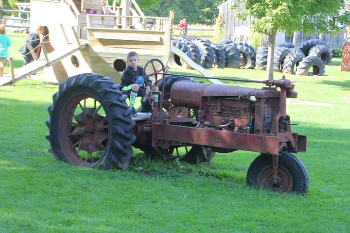

I have two repowered F12.One has a 4 cyl flathead (military)Jeep.The other,a 2.8L V6 from BroncoII.The Jeep engine has the 3sp trans hook to a short driveshaft.The V6 ,O built an adapter to plug directly onto the clutch,elimanateing the need for an extra trans.I know of a F12 in the next town with a 6 cyl Chevy.
Ss55,the V6 powered one is my puller at the local tractor pulls.Makes lots noise and dust.The crowd loves it! We call it thr 'Rat tractor'. :)
That is my kind of a fence row! How was the v6 conversion for a working tractor? Looks like you gained weight and traction with the rear tires but my stock F12 and F14 always seem light and underpowered, use the fast hitch super Cs a lot more for raking and odd jobs. Mike

The V6 is not a working tractor.It is strictly a puller.The fully restored F12 would actually pull more wt because it pulls till it runs out of power.The V6 gets out there and just spins and jumps.The V6 engine has to be wound up to have any power.At low speeds it just falls flat.But it puts on a better show.The weight of the two is almost exactly the same.
