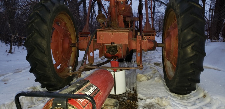

Just bought a Farmall H with a front loader a few months ago and it ran fine until the second time I tried to use it in snow. I got it started and moved it about 50 ft when I felt and heard a loud clunk and it slipped out of first gear. At first the engine would stall when I released the clutch. After a few tries, I got it back in gear and drove it another 100 ft then used the loader to scoop a bucket of snow. This time when I changed gears, I heard and felt the same clunk and the engine stalled every time I tried to release the clutch. The shifter changes gears and the tractor can roll back and forward no problem. In fact I used my 4x4 to tow it back out of the road and up onto my property again.
Can anybody tell me whats wrong here and how to fix it? Thanks.
It seems like I have the exact same problem as this other post: https://www.yesterdaystractors.com/cgi-bin/viewit.cgi?bd=farmall&th=639112. I was just wondering if billde could complete the list that he started? I'm going to try the suggestion of melting the ice out, but it may be more than that with mine because I heard and felt a clunk before it stopped working. I hope someone here can give me some good ideas. My tractor is a Farmall H from 1946, and this will be my first time working on a tractor since I was a teenager.

It is a good bet that there was some ice in the bottom of the rear end and a chunk of it has moved , jamming the rear gears. Heat the rear end with a heater of some kind , open the drain plug and water will run out ahead of the transmission gear oil. I have two H's and one of them did what you described. Once the weather turned warm I drained both H's of their water and got over a gallon out of one and about two gallons out of the other. I went to look at an H for sale and told the guy it had water in the rear end , he didn't believe me so I got a wrench out of the truck and a pail and I drained it for him , he was awed by the amount of water. I'm betting water (frozen) is your problem

Heating the differential and transmission from the rear with a torpedo or rocket style space heater of about 150,000 BTU's did the trick in pretty short order.
I heated it for around 45 minutes, then opened the drain plug. A little clear water came out then there was a gush of dirty brown fluid.
I closed the drain plug as quickly as possible, but there was a pretty good gush going on. Over a half gallon of the Brown stuff escaped. I don't know what the transmission or differential fluid is supposed to look like, but I doubt it was supposed to be that color.
Anyway, after I got the plug closed, it started right up without depressing the clutch pedal. I drove it a short distance, but it was making noise like gear teeth knocking together so I shut it down. I figure I now need to replace the fluid.

When water and old gear oil mix it looks like carmel , a muddy brown colour. There is a chance that H has never had a fluid change in years. My recommendation is to completely drain it and then refill with the proper gear oil. Also , when you fill it it will leak. Under the belly pan cover you can see the drive shaft. The seal on the drive shaft to the rear end usually leaks because of age and wear. The seal is easy to change and not expensive , if the shaft is worn a speedi sleeve will fix it with a new seal. It is an easy job with a few tools. Good luck with your H

Trying this now: I have one of those rocket style heaters which I will point at the bottom back end of the tractor for a while and open the drain plug to see if that does the trick
