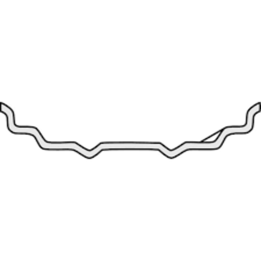

My nephew took a picture of it when we picked it up and it does have a 6 hole hub. I am going to try to attach a picture so maybe you can tell me if the rim is double bevel or drop center. This is the only picture I have of it.

The image shows the two ribs that are formed in the rim material allowing more adjustability. If yours have two, they are double bevel.
In addition, the measurement is from where the bead of the tire touches the flange on one side to where it touches on the other, where in the image the bead flanges are vertical. It does not include the thickness of the metal, or the little lip at the outer diameter. if you bend a coat hanger to touch the rim, both inside and outside of the rim as above, and measure it , then subtract 1/2" you will know for sure the rim's generic size. a 10 or 11 inch is ideal for the 12.4 tire. Jim

First are the rims of the double bevel, or are they the drop center ones. The reason for asking is I don't think there were rims for the drop center with enough width to put properly fitting tires of 15.5 on them. So maybe somebody changed the wheel casting to the double bevel off from a 300 or such. This could make his changing them back to 11or 12 inch tires more costly. If they are of the double bevel style I would just keep the bigger tires and thus more weight capacity in the rear tires for ballast. As for the stability only had one tractor tip over in 60 years and dad was driving the WC carrying trusses for a new pole barn when one front tire went over a chuck hole. Would not have thought going that slow and the truss just off the ground would have caused that. Set it back up and away we went again. Just watched out for the hole afterwards. Don't think anybody saw the hole before that.
