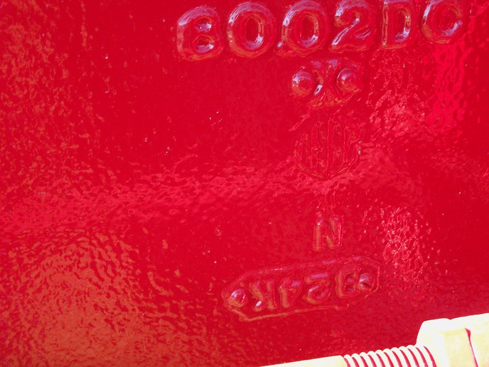

Where is the casting code on the transmission case of a Farmall M ??? Thanks, Ellis

As said,on the left side,in front of the brake pedals. It will look something like this: 11*14*O (November 14,1945)

Not to common but sometimes on left side. Picture of left side and upside down near clutch rod adjustment. Some had a date number instead of letter more common around 47 and 48.

Brake pedal side, in front of the pedals.
