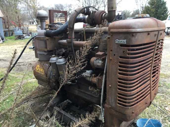

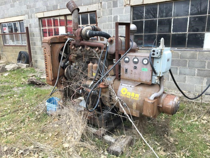

I have lurked on here for a while and I can usually find the info I need, but I am stumped now. My Aunt is selling off the shop and part of this is an Onan generator connected to an IH UD? engine. Its a 4 cyl with a turbo, starts on gas then switches over. I can't ID this thing and the pictures below are all I have to go off of, it is in Kansas and I'm in DC, and the Aunt is in Nebraska. I just want to know what this thing is because I think it is cool and I want to give her the best info for her auction. Since I grew up with Allis Chalmers, red stuff scares me.

Is MW a brand or a model number for the turbo?

M&W is a company (still making things, but not tractor accessories) that made hundreds of components for tractors (I think mostly IH, but others as well) from throttle levers to PTO handle extensions, to governors that clame better response, to turbo kits, and transmission gear sets that added 4 more speeds to a Farmall M. Jim

Thanks for all the quick replies! The engine still runs, or did a year ago when my Uncle died, the generator stopped making power that same day. It is on an online auction so I'll get the title updated and see if someone local can get a picture of the data plate on the bellhousing.

ud14 with a mw add on turbo seen a few of them

Looks to be a UD14A that someone added a turbo. Look at the engine block just below the head and behind the injector lines clamp for a stamped in engine prefix and serial number.

Appears to have aluminum tag on left side of bell housing. This probably has the info you are looking for on it.

looks like the UD14 engine like the one in the TD14 ih crawlers. they are 461 cid. engine. same bore as the wd40. looks too big to be the ud9 as in the wd9 tractors. that turbo is an add on, ih did not have turbo's on those engines. plus the oil filters are ud14 not ud9's. the UD14 was built from 1940-1947. but,... look on the engine serial # plate and it will tell you exactly what engine you have.

That must be a TD 14 engine,looks to wide like others have said to be the 248 engine!

UD, stands for utility diesel, that looks like a MD, or the Super MD family of engines,except i never seen one with a turbo on it, Chances are it doesn't have many hours on it and it's been inside, they will last a long time. They do start on gas and switch over to diesel!

Pretty sure it's UD9, or possibly a UD14.
Only UD family engine with a turbo I ever saw was a 6 cylinder UD24 with what looked like a factory-installed turbocharger in a TD24 crawler. But the turbo in your photo looks factory as well.

Given the size of the grill, I'd guess the engine is the same size as a WD-9's engine. I wonder if they made turbos for 9's. jal-SD

The Onan DBY used the I-H UD-14A. 35kw.
Bore 4-3/4
Stroke 6-1/2

UD 14 for sure
