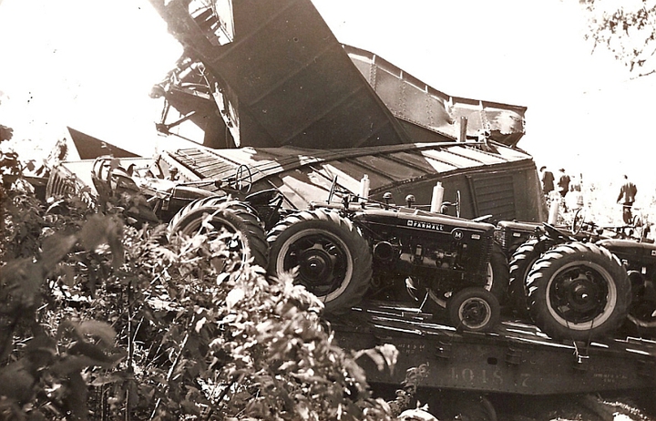

From start to sometime In Feb. 1940 only one type seat was used. Then to 1947 the seat with thick spring between operators feet was used. Also the standard seat through production. In 1947 the hydraulic seat attachment with shock at rear was available from IH. In 1948 they changed the hydraulic seat a little and moved the shock to under the seat. Some early transmission top covers after the slot top only had two bolt holes instead of 4 for seat mounting into 43 if I remember correct. From Feb. 1940 to end any of seats other than first type will work. At one time the hydraulic seat attachments were sold with the foot starter switch brackets that went on the steering post. If I remember correct this picture is from 1948, train wreck with factory shipment of tractors with shock at rear of seat.

I would have swore the assembly with the long shock was later than the small, and it was not an IH seat assembly. I have no clue where I read that. Why does that assembly not show up in the parts book, or does it?

Not pictured but you can find the part number break in parts book at the hydraulic seat assembly. Notice the shock, frame and some other parts shows a parts break. Has the start serial number on a M of shock under seat. It shows the other type from end of slot top up. But Don't think it was available as a attachment from IH until in 47 or no earlier than real late 46. Don't show up in a parts book until after 47. Don't know how much parts book printings lagged behind part use dates.
