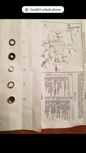

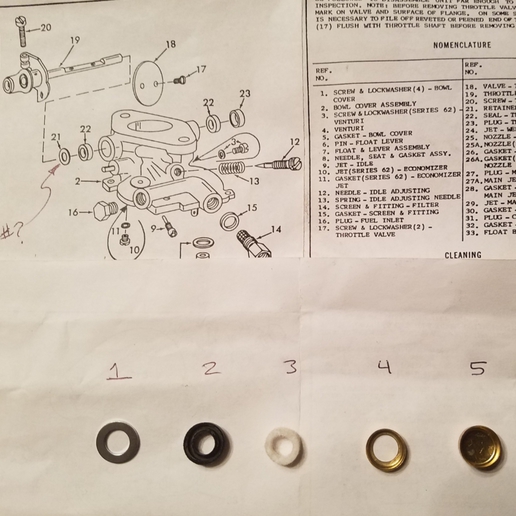

I think I have a leak at my throttle shaft. Can someone identify the seals I have in the following picture. Is the following correct?
#21-----1?
#22-----2?
#23-----5?
What about the felt #3 and cupped brass thru hole #4 ?

Unless throttle shaft bushing is BADLY worn, it will not leak enough air to affect idle much, IMHO. Seals should be in place to keep dirt from being drawn in.

I think the felt goes in the hole then the rubber seal with lips facing outward then the solid brass cap on the blind side. The other would be the same but use the cap with the hole to accommodate the shaft.

The felt seal is for the choke shaft, the rubber "VEE" seal is for the throttle shaft, only need one, brass "plug" with no hole seals other side..
There should be two brass plugs with holes, one to retain the choke shaft felt, and one to retain the throttle shaft "VEE" seal.
Dunno what #1 is but I don't think it's used in this area.
