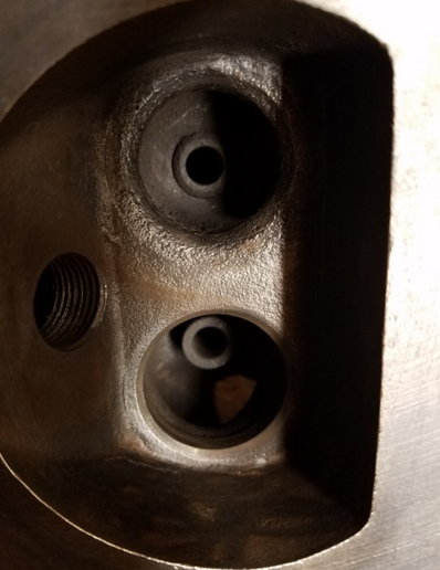

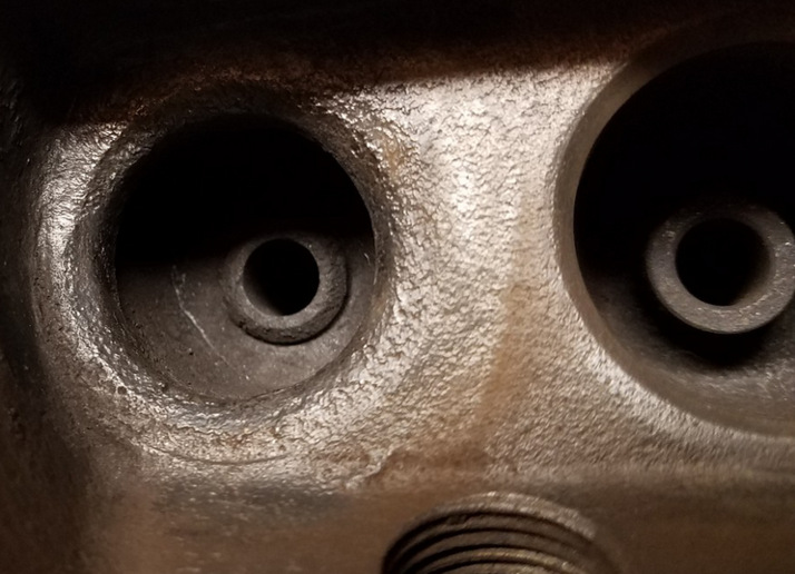

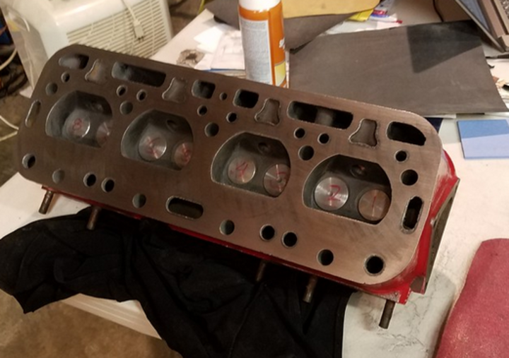

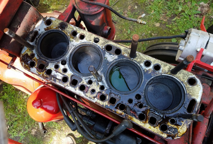

A week and half ago, I decided to put a snake camera into the spark plug holes on my 1940 A. I found a puddle of antifreeze sitting on top of #3 piston and could see that the head was leaking at the gasket. I immediately tore off the head and found that the gasket was in terrible shape. After more inspection I found that two exhaust valve seats were completely gone! I can't understand how the old girl even ran!. After a lot of hard work without power tools I reground the seats and lapped the new valves (purchased kit) and installed them, springs included. Guides were within in tolerance using go/no go gauge. I checked the head for flatness and found it to be .002/.003, I figured I had it opened so I used progressive sanding and got it super smooth and down to .0015/.002 I had compression of 80-85-60-85 going into the job and now after heating it up and re torque the head and setting the valves hot, I am now at 95-98 on all 4. Cylinders were all smooth and looked good. Checked all piston journals and bearings last year.

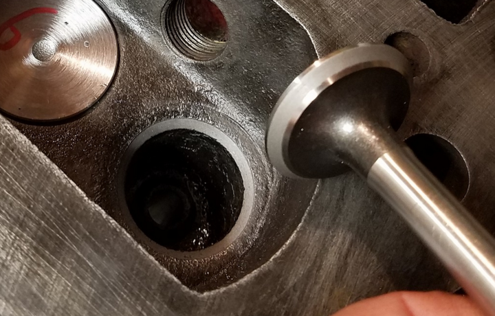

that rough seat in the picture has had water sitting in it to corrode it like that. that's what happens to these engines that people get running that have been seized up. there is nothing in them, but yes they will run. should have had a new seat installed. plus those valve seats are waay to wide on the valve. that is the problem with lapping, it is no longer used. it is 1920's technology. the seat should be about 1/2 that width and in the centre of the valve face. with that wide of a seat good chance of carbon getting stuck in between. not running down your work as good job with what you did with what you had to work with. just that there is no such thing as lapping valves anymore. the seats are ground to 45 degrees and the valves to 44 degrees this gives a fast valve seating and if carbon should get caught inbetween it will work out.dont know how you can check valve guides with a feeler guage. about .003 is good.

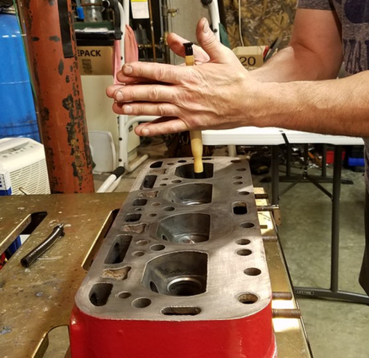

Looks good. On valve in head engines we have used an electric drill to lap valves like that.Just tighten the chuck on the end of the stem. Never did one with the seat in that bad of shape though. We use a pencil mark for a fit gage if it wipes a pencil mark out when turned by hand it is good.

For a daily use working tractor as some have said the valve seats are a little wide but for your app it'll be ok.
On higher compression engines like my diesels sanding the head smooth and flat is a no no, the small groves the cutter wheel leaves when a head is milled flat helps hold the gasket in place and keeps it from being pushed out, again not a issue in this case.

Thanks, you said the same thing my father did (Mechanic of yester year) He said it was low compression designed to replace the horse LOL. Yes the shoulders are at .090 and the spec is .078. I needed to keep going until I had a full seal (Tested it). If I have a problem down the road it is not like I am using it for an income. I will tend to it again. My father told me he had a valve grinder like that.
I didn't want to chuck to valve stem due to not being able to control lateral movement. I did slip and air hose on the stem and hand spin in because the suction cup kept popping off LOL.
