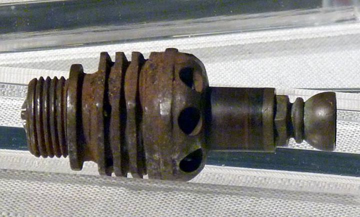

Mr. Champion got his spark-plug ideas from a French spark-plug company named Nieuport. He was said to be kind of an angry guy. He got in a fight with another man who he claimed was hitting on his wife. He got decked by the guy and died from the beating.
So much for the great history of Champion and "Albert Champion" spark plugs.
With small engine use, we had many failures with shorted insulators with Champion plugs in the mid 70s. The problem was quickly corrected and Champions have been fine since. They come OEM on many cars and trucks. Not sure what all the moaning and groaning is.
Here is what the original Nieuport spark plug looked like that Albert Champion built his two companies on.

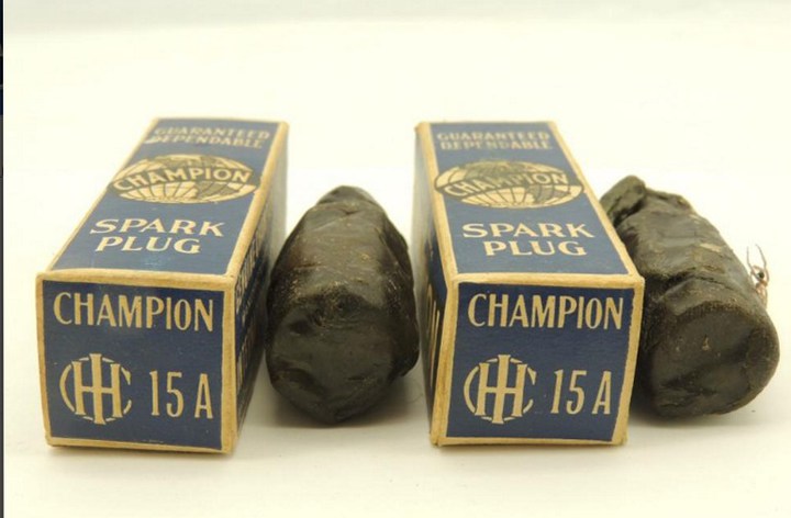

Here is what the Farmall A came with new. Subs to a D15Y or D18Y now.

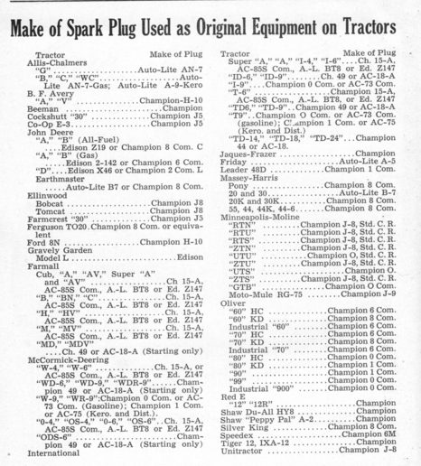

I have three Champion books here. 1968, 1976, and 2008. For a Farmall A, they all show a "turbo-action" plug designated by a "Y" at the end. Either a D15Y or a D18Y. 18 mm, 1/2" reach, turbo action, and 7/8" hex. The hotter D18Y for light service and colder D15Y for hard service.
