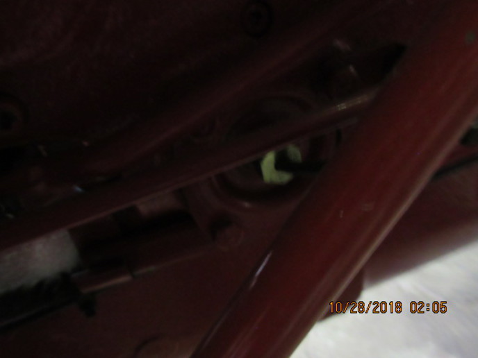

I have this style hitch on my tractor and the literature I have shows nothing on this style. I know is a 2 point fast hitch, it's just know its not the traction control with the handle down behind you on the left. I also have this bar on the right side that goes down to the hitch. Can anyone explain this for me?

someone added a fast hitch from a super c or a 200 to your 230. the 230 fh didn't use the tool box as part of the hitch. the rod on the right side extends out and hooks to the odd positioned holes on the touch control (one that has the hairpin showing in gab's pictures). that rod controls the depth when you are plowing, and in my opinion, is far superior to the traction control system you mentioned. I have plowed with both.

Same as the hitch on my Super C, think bar on the right is called draft control and hooks to the Touch control arm, flat bar on left side tips hitch side to side. If you want down pressure on your hitch you need a pin in the bar behind tool box. third party image

Looks like I'm missing the leveling link or the bar on the left hand side. Guess I need to locate one. Thank you everyone for your help. It's going to be a little chore tractor, clean up turn rows and cut drainage ditch around the farm. Maybe pull a trailer or two around and take to tractor pull. I was going to turn it into a 4 row cultivating tractor, but plan on taking on more acers and need something bigger. I can see the advantage you guys talked about with this hitch. Thanks again.
