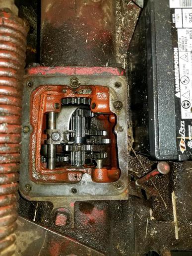

So i bought a cub on Friday. It has 2nd and 3rd, however the linkage for reverse and 1st isn't attached. I believe its in the bottom of the housing because every so often it makes a grinding noise and then jams. I'm just curious to see how difficult its going to be to fish that out of the bottom and install a new fork, or do they even make replacement ones?
Getting it out with a magnet retrieval tool. fish for parts big and small! Replacement used should be easy to find. Jim
