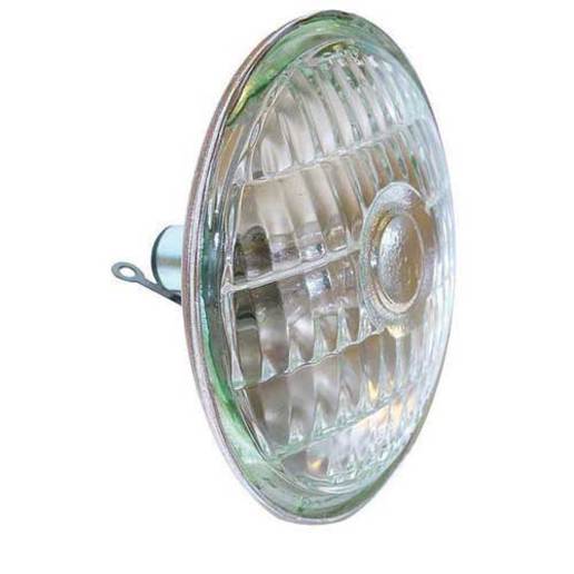

The original lights have a small brass tab on one side to ground. The rubber gasket maintains that connection. No wonder many don't work. I bought mine from Case IH. Take the old one to compare because there are 3 styles.

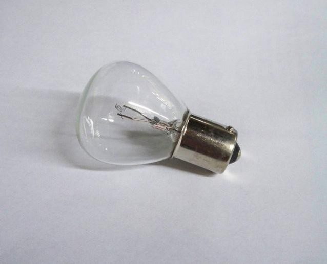

The ones with the brass tad were never used on the M lights. It was used on the Super M for headlights ( sealed beam headlights). The Ms used a bulb. Top photo is what your talking about fits a Super M and bottom photo is bulb of M.

None of mine ( M & B) with bulbs have a brass on them.

The brass tab is on the inside of the housing and makes contact with the metal reflector to complete the circuit for a bulb. The gasket holds it tight.

Like I said the light bulb for an M did not have that tab. The bulb (sealed beam) for the super M and newer tractors had the tab. They both used a gasket.
