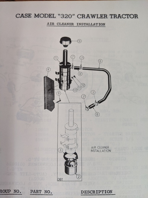

I was wondering the extra hole in the cowl is for. There is a plate on the side of engine that must have held something.

now it makes sense! the previous owner to mine must have modified it with the above cowl air cleaner/oil bath. it did seem a little weird to have it mounted on top of the cowl.

These dozers had 3 holes across the front there: the LH one is for the exhaust, the center one is for the engine cover breather, and the right one is for the air cleaner. That plate on the engine is what the air cleaner attaches to. I'm looking for one of these for my dozer, myself. They tend to get hit by trees and other stuff fairly easily, which is how mine was lost by the previous owner.

Quoting Removed, click Modern View to see Before I removed the cowl, there was a red oil filled bath air cleaner sitting on top of the cowl. it was connected by a metal tube that went through a hole and to the carburetor. it looked all original - so I don't think the unknown is an air cleaner.
