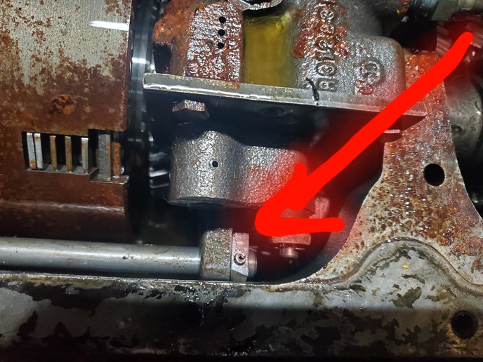

took top cover off of my JD 450 tranny to see why I only have 80 pounds of pressure. Figured sheer pin was broke but it wasn't. The the rod that has the arm on it that opens the valve for the fluid. Could that valve be junk? Clutches look great. Was working good for a few days then lost my 150 psi of pressure. Can anyone help me please

In your second pic there is a hole in the line
Better check it out

it looks like a hole but its not. Its a black spot on line

Are you seeing bubbles directly from the clutch packs or from a return line into the case? Does it bubble all the time you have air on? Your manual should describe there are paths for excess oil to return to the case after the filter and cooling needs are met. The valving and circuits is likely passing your air through them as well as the clutches.

no it bubbles directly under that valve body where I took the line off to put air. The bottom side.if I recall when in neutral it doesnt bubble. Jim like you said before it probably is a bad pump housing. Almost impossible to find though

Yes a valve could be bad and hanging open a bit. There could be a pressure leak somewhere. The pump may be weak. Beyond going through all the adjustments and pressure checks again to try to pinpoint the problem, I don't know what to tell you.
From your posts on the John Deere Forum you had a good bit of wear in the HLR pump that you reinstalled when you changed the input shaft. It may not be able to make full pressure or volume any more. If you have a leak in the HLR oil system the pump may not be moving volume enough to hide the leak and build the required pressure any more.
You say the clutches look good. I don't remember if you completely disassembled and resealed the HLR or not. It is unlikely both clutch packs lost their seals at the same time. Since you lost both directions I would look first at things common to both directions. Starting at the pump suction through the direction control valve.

how do you test for leaks with air? My manual doesn't say. When I put air to clutch housing as I have in the picture when I shift through foward and reverse the fluid bubble in case. Is this normal

If you take off the upper valve from the lower valve block [2 5/16" bolts ] Watch you don't loose the itty bitty clip that secures the shift rod to the valve lever. There are 5 o-rings in there .. each seals a function.. You can air up the clutches by putting air into the sealed holes with a rubber tipped blow gun.. Should show leakage that way. Man, that's an early one you got there.. I haven't seen threaded line attachment fittings in a long time.
