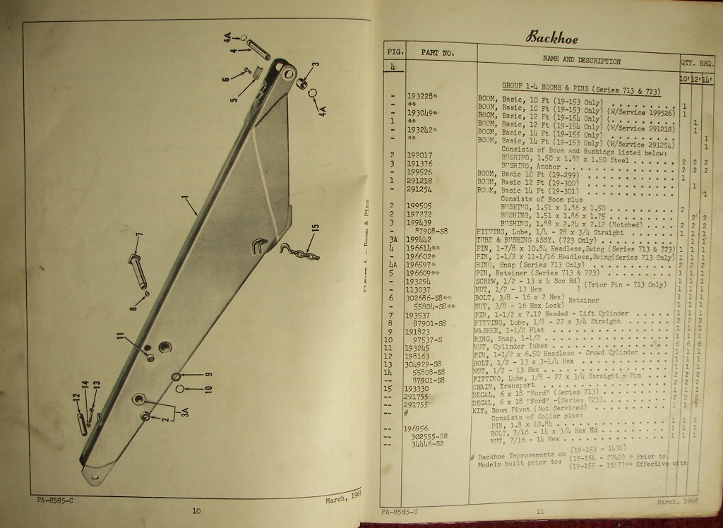

hi all: I am in need of an image that shows the arrangement of the upper and lower crowd cylinder bushings and it's related parts, and if possible where I could purchase new ones if needed. I am replacing the crowd cylinder and it looks as though it is intact however when I removed the old damaged one and the pins there seems to be a few parts that are extra or better said "i don't know where they should go" in the reassembly ? ALSO i HAVE COME TO REALIZE THAT A PARTS MANUAL FOR THE RIG IS A MUST ! ANY thoughts as to where I may obtain one for the 713 ?? Any and all comments are as always apprciated...thanks for now..p.s. emails work too

Andy and all: thanks for your comments to date I believe that I will fabricate if I cannot find a source for the needed parts and I have located a parts book thanks again to all...jim in ny

For what it's worth here are the parts pages for the upper and lower attachment points for the crowd cylinder. Typically with the 713 you're on your own for parts. This means fabricate, have someone else fabricate, use off-the-shelf substitutes, or look for used/salvage yard parts. Fortunately most pins, bushings, and retainers are pretty simple. Original parts manuals occasionally come up on Ebay.

Parts books are on line at the New Holland part site. https://partstore.agriculture.newholland.com/us/parts-search.html#epc::model_find. Do a model search for 713 and several variations will come up to select from. Then you can check with your local new Holland dealer. With the part numbers you can search and may be able to find some aftermarket ones at vendors on line or on eBay.
Check with the YT store to see if they have a manual. eBay can be a source for used OEM manuals and reprints.
