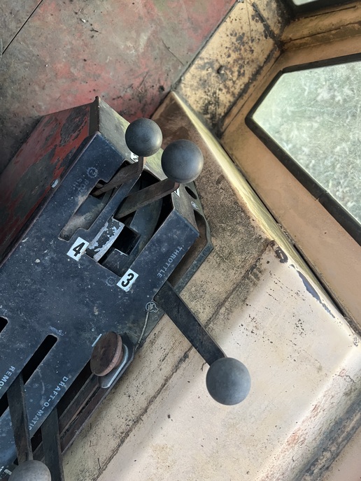

I have an 870 case that makes a squal in reverse but stops when u push in the clutch. Is this normal I have changed the filters on the side and fluid Anyone have any advice

These guys on here are all smarter than me, but I don't think it is normal. Whether the clutch is pushed in, or whether you are in reverse, the same set of planetaries is engaged. Hence, the noise is about the same. We have had an 870 here for years, and numerous other CASE tractors w/ the same P/S tranny and in reverse none of them make that high pitch whine that I just heard in the video. Have you looked at your filters for metal? Crack the drain plugs along the bottom of the tranny & diff housing and look also.

newJd4430
11-21-2023 00:01:48
Report to Moderator
 Re: 870 case tractor makes a squal noise in reply to used red MN, 11-20-2023 22:53:29
Transmission picture Third Party Image

That is a normal sound for a power shift.

Agree, normal sound of reverse in a Case Powershift of that era. A planetary set operates at a fairly high speed
In reverse on those. Thus all the warnings about not to leave it in the reverse position while doing stationary PTO work, proper lubrication to that gear set becomes an issue in that case.

If it's a power shift transmission that's normal, just do not leave it in reverse when it's sitting running
