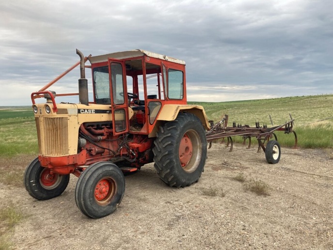

GreenEnvy
11-18-2023 14:01:28
Report to Moderator
 Re: Case 930 in reply to olgentdc, 11-18-2023 05:35:18
Third Party Image
I'm with CC on this. I've never seen anything out here in MT other than 6 sp 930s with hand clutches Comfort King and not Comfort King. Not rare at all. So from my point of view 8 speed 930s and any 930 with a foot clutch is rare which I know isn't true. . I get to run this thing for a couple hrs every year plowing a shelter belt for one of our landowner's. 6 speed hand clutch CK 930.

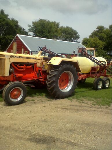

casecollectorsc
11-18-2023 06:02:04
Report to Moderator
Didn't think the hand clutch was that rare. Have 4 six speed 930s and 2 are hand clutch. First tractor I bought was a 64 Western Special 930 with hand clutch 55 years ago. Latest Case built them was 1967...have one.
Third Party Image
