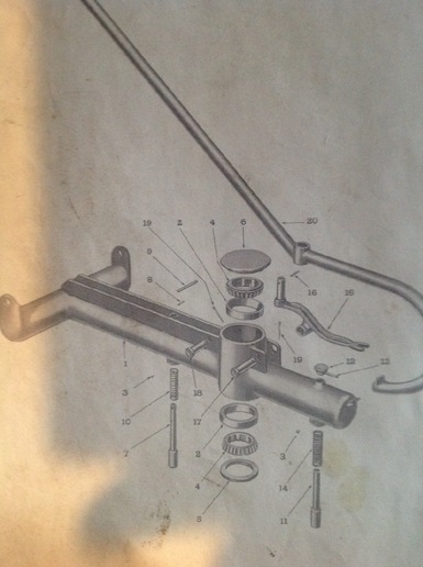

unfortunately my lever got bent out of shape at some point in its life so I still have to get off and adjust it. perhaps one day I will get that fixed.
On second look, I see what you mean. Mine got seriously bent also but with heating it with a torch and holding it in a large vise, I was able to straighten it. The bearing in the swivel went bad on mine and, remarkably, with an Internet search I found and copied the original manual, and was able to get the bearing and race.
