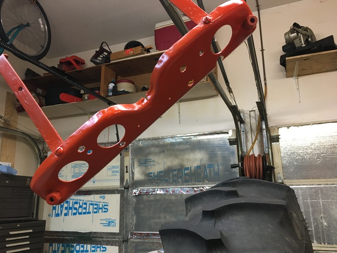

Earlier this fall I brought home a new to me DC -4 late model,
from Polk city Iowa. And I promised Gary I would re-post this
picture. We are buttoning her up as we speak this weekend
waiting on a Mag from Kevins Mags in Illinois
Nice looking tractor! I did the social distance purchase from a fellow YT'r in December. I send all my mags to Kevin as well. What all did you do to your tractor?

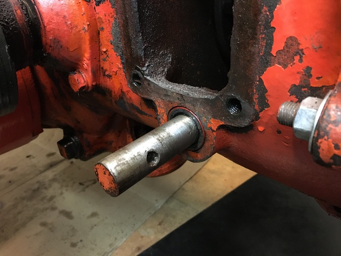

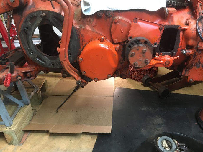

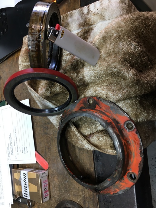

Morning J! Pastor John offered me a new used pair 13.6-38s, New water pump and generator belt, new axle seals differential shaft seals,Clutch housing shaft seals, New seat support bushings, and hydraulic control arm O-rings, just to name a few. And of course a new set of 31 to Bull gears and chains. Let’s hope we haven’t missed any!. CM many thanks to John and Chris Saeli for supporting me in this project!

Oh wow! You're in a lot deeper than I'm doing. I'm doing an engine rebuild on an SC along with replacing the broken 1 1/8 PTO shaft to 1 3/8 shaft. I just got the rest of my valve train parts from John Saeli yesterday, so I'll be taking the head to my machine shop on Monday. And I recently sent the rod bearings to Don L to be reconditioned, then I'll be ready to start reassembly.

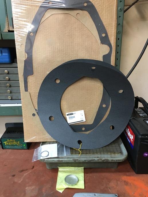

Yes you do Jerry. I contemplated, Using gasket eliminator by Loctite instead of gaskets, since actual houses had to be removed anyway, I went forth with new gaskets. No time to go cheap. CM
