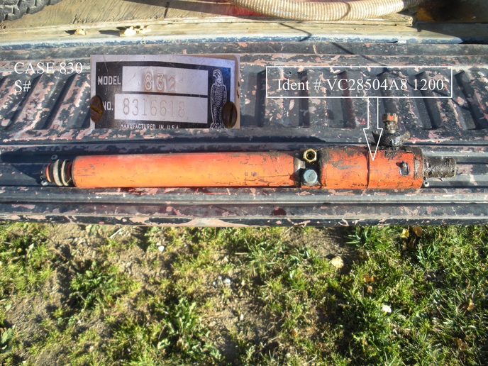

I own and operate a CASE 830 Diesel 8 speed Transmission.
Picture, is of a spare power steering cylinder that I have...I was informed when I purchased the 830 the cylinder was off another case but required parts.
Could someone tell me if the CASE 830-930-1030 use the same power steering cylinder.
Cylinder Ident # VC28504A8 1200
Is this cylinder a CASE manufactured part....or from a hydraulics supplier ??
Winter is around the corner. I would like to have a spare functioning steering cylinder.
Thanks

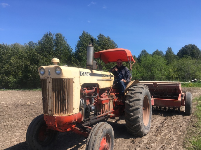

Looks the same as the power steering cylinder on my 730 Case.
Third Party Image
This cylinder weeps a bit, thatís why it is so dirty, and the tractor gets used in some dusty conditions, like planting grain. And because this is just another farm tractor and not some show pony, I donít keep it washed down. So as I said it weeps some, but doesnít bleed fluid. It did bleed, and we took it apart and replace the seals. And my 930 and 1030 have a completely different set up. The 730 and 830 share many common features, just as the 9 and 10 do.

1030 never used that cylinder nor did the 8 speed 930's

I received the below info from a Tractor parts/ salvage yard.
Hi, afraid we do not have anything left here and I checked our aftermarket suppliers and nothing there either. It also appears that this could either be a Ross or Monroe cylinder just so you know, not sure if they are interchangeable or not.
Is a ROSS or MONROE cylinder familiar ?

IIRC there is a shop in Kingsley Iowa that can fix or make just about any hydraulic cylinder.
