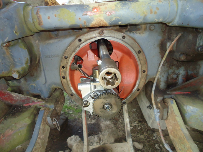

joestewart
07-30-2020 14:35:22
Report to Moderator
 Re: Case 990 hydraulic system malfunction in reply to gwayne919, 07-29-2020 23:13:25
Here is a photo of the hydraulic pump on my 990.
Note: All the service manuals are free and downloadable at the following link:
[Log in to Reply]  [No Email]
gwayne919
08-01-2020 19:50:59
Report to Moderator
 Re: Case 990 hydraulic system malfunction in reply to joestewart, 07-30-2020 14:35:22
Beautiful. I'll be downloading the free manual and determine if the e-ring needs removing from the shaft sticking out of the upper bearing after I removed the outer housing. I thought that it would be a lot of heavy work and I got out my portable hoist and removed the seat to get at the housing better.
Thank you Joe Stewart. You have been very helpful for an old retired farmer.
gwayne919
08-02-2020 11:19:58
Report to Moderator
 Re: Case 990 hydraulic system malfunction in reply to gwayne919, 08-01-2020 19:50:59
The E-ring didn't need removing and I realized that early on and it took a come-along hooked to my truck hitch to pull the housing free from the tractor. Everything is as described and after disassembly the pump housing is chewed along with excessive gear and bushing wear and that was the problem and it showed up after 13+ hrs of work. This 990 has over 3500 hrs on it when the hour meter died and it has a new one now along with lot of other 21st century goodies such as a one-wire alternator. I converted a bottle jack to test and adjust my injectors and had the injector pump rebuilt and it'll last till I'm in the grave.Thanks for the assistance.
