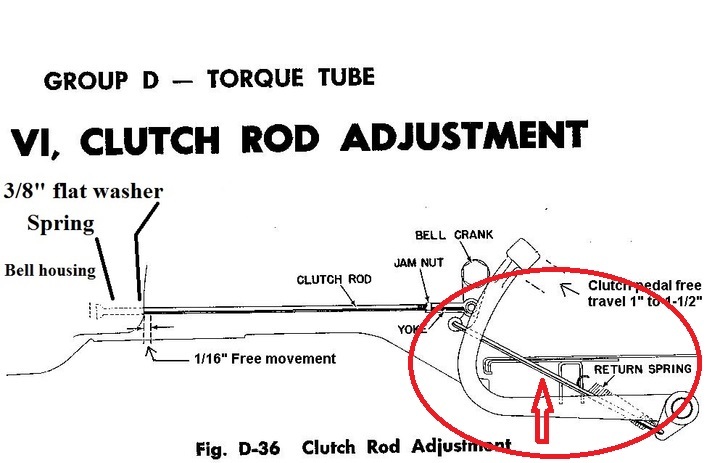

Hi there,
I am looking to find a replacement clutch pedal rod for our 1956 Case 310B. If anyone has a good source, I'd love to hear from you. I've got calls into a couple different part houses, so I'm hoping something turns up.
Absent finding a replacement (part G10748) one potential option is trying to fabricate a new one. Unfortunately, I don't know the specs for the part (length, rod thickness, length of 90 degree ends). If anyone has the ability to provide those numbers that would be greatly appreciated.
I realize that welding our current (broken) part could be an option, but it appears that a small segment may have broken out, so I'd still be unsure of the length.

Hi Joe, thank you very much for the information. I'll be sure to reach out to those two gentlemen to see if they can help.
I appreciate the additional information about the clutch rod, but I'm actually looking for the clutch pedal rod which is a different part. I didn't mean to cause any confusion - I just went with the name that is in the Case service manual.
Since the clutch rod is 5/16", I'll go out on a limb and guess the clutch pedal rod is the same thickness. So, I'm 2/3rds of the way there with measurements.
The part I'm looking for in your black and white photo is the straight piece that is adjacent to, and just below, the return spring. On that drawing, the rod is not labeled.
I'm sorry I have to describe it to you, but there is something going on with photos when I try to post them. I get an error message that there are words or characters in my post where the system believes I am a bot or a spammer.
I have the drawing marked up, but I don't know what's going on. I can "preview" my post with the photos, but I can't "submit" my post without receiving the error message.

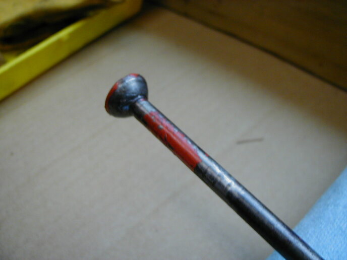

I think I found a way to add the photos from the classic view side of the house.
One photo is the part I'm looking for on the diagram that Joe sent, and the other is the actual part from another site. Hope these help to clarify.

The link is 5/16" dia. I have some heavy stuff stacked against the tractor can't good enough access to get an accurate length measurement.
I would bet Don L will have them, he has a big salvage yard in MN.

I should have looked up your p/n before posting. Anyway no harm done. The part is generally referred to as a link but it is part of the clutch rod arrangement.
These are some of the tractor models that have that part in case you have to do a salvage yard hunt.
G10748 LINK Case parts 600B-SERIES, 630, 430CK, 470, 300B-SERIES, 320, 430, 400B-SERIES, 320B, 420B, 420BD, 530, 530CK, 300-SERIES, 500B-SERIES, 570 LINK
Your tractor is one of the models in the 300B series, 310B is a utility tractor that only built in 1958 & 1959. If the model/serial tag still exist post the serial nr so we know which year it was built as some parts change by serial nr. If the tag is missing post a pic of the steering wheel and I will be know the build year.
Don't assume that the part is 5/16", I will check in the AM and post back if it is other than 5/16".
