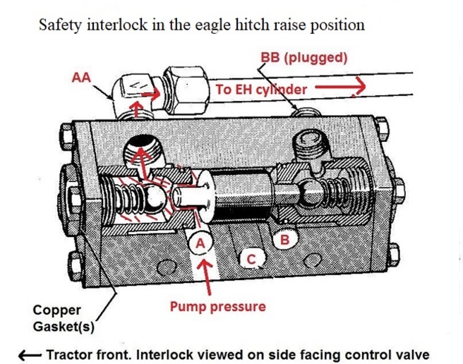

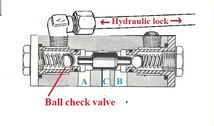

This is how SA interlocks work:
Raise position: Control valve stroked to apply pump pressure to port A which pushes ball check off it seat
admitting pressure to EH piston. The number of copper gaskets under the cap on the end increases or decreases
spring pressure on the check ball, that may be a factor in seating the ball check after pump pressure is
ceased.

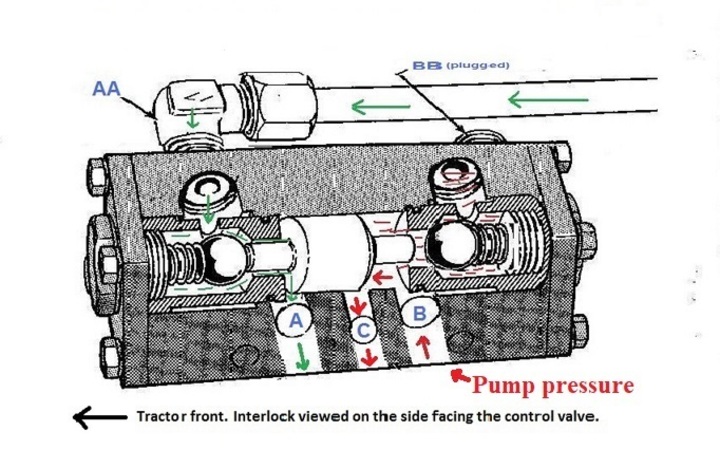

Lower position: The control valve is stroked to apply pump pressure to port B stroking the spool to the left
unseating the ball check, breaking the piston hydraulic lock, and providing a path back through port A for the
oil to return the sump via the control valve and return filter. The pump pressure not required to balance the
ball check spring tension is dumped through port C. The design here is to provide some oil in circulation for
the pump and also to avoid have the pump running in relief. So again ball check spring tension is germane.
Neutral position: If the control valve spool is definitely in neutral, there is no pump pressure to the
interlock. The ball check on the left is maintaining a hydraulic lock on the piston.

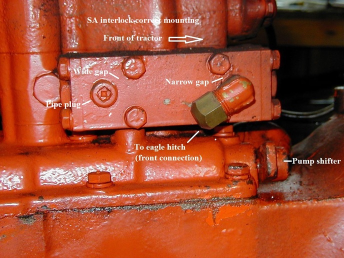

SA interlocks sometimes get swapped with a DA interlock in which the pipe plug in port C has not been removed.
An interlock may be bolted up end for end which will misalign and block port C and restrict the other ports
about 30% but will still operate the EH. The problem here will be that port C will be blocked and the pump
will apply full relief pressure on the spool compressing and possibly weakening the ball check spring, as well
as, running the pump at relief valve pressure while lowering the hitch. So if you are lowering your hitch and
the engine grunts your linkage may be stroking the control valve or you might want to check the interlock
bolting/fitting clearance.
So that's just about it providing the interlock is SA, hasn't been installed end for end and there is no pump
pressure to the interlock. If the piston seals are not leaking, there are no other leaks between the interlock
and the piston then the fault is in the ball check/spring. Might be corrosion, debris in the oil, weak spring
that is preventing the ball check from being oil tight, spool is sticking, etc..

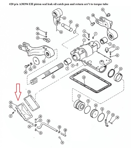

Some of the later tractors had a catch "pan?" and tube to convey any piston seal leak back to the torque tube. I can't find any evidence of
that at the Caseih site on any tractor, it may not be listed with the EH parts. I remember CNT mentioning that but don't remember what
year/model that leak recovery system was installed. Might be worth it to page CNT, Loren, or one of those experienced guys and ask about it.

Joe, check out the 530- 570 DOM tractors on the parts site, I researched that last nite and found it. I was wondering also about that but could not find any indication it was used on 530s. It was even difficult to find the top and piston breakdown I had type rock shaft into the search box then found it.
Thanks mEl, I found it where you pointed out. It is listed as used in the later models of these tractors:
Eagle Hitch piston seal leak off oil return to torque tube
A38394 PAN - oil return (tube approx. 13-1/8" long)
(430) - CASE DRAFT-O-MATIC TRACTOR (S/N 8297801 TO 8650135) (1/65-12/69)
(470) - CASE TRACTOR (S/N 8656925 & AFTER) (1/70-12/72)
(530) - CASE DRAFT-O-MATIC TRACTOR (S/N 8297801 TO 8650135) (1/65-12/70)
(570) - CASE TRACTOR (S/N 8656925 & AFTER) (1/70-12/72)
(580) - CASE CONSTRUCTION KING TRACTOR (BSN 8685800) (NORTH AMERICA) (1/66-12/71)
(480CK) - CASE CONSTRUCTION KING WHEEL TRACTOR (1/66-12/71)

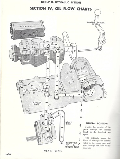

That doesn't show up on olgentdc's 600B. I don't believe there is any other way to break the hydraulic lock on the EH piston other than a leaking interlock ball check or piston seal leak. Any comment on that?

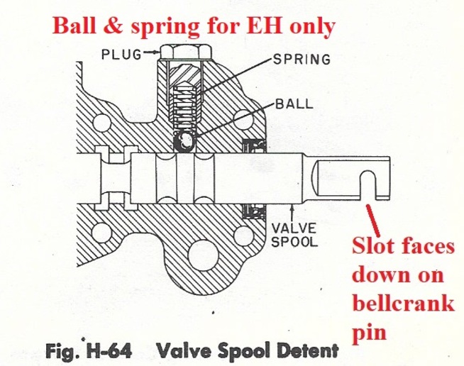

Joe, Thanks for sticking to this with me. The slot on the valve spool faces down, so that is correct. The detent ball is also there. That was one of the things I checked earlier. The interlock for the remotes is just above the one we are discussing. The manual I have shows to put a gauge on the plugged outlet on the interlock to check for back pressure. If the back pressure reaches 75lbs. it could cause a slow drop of the eagle hitch. I hope I'm reading that correctly.(?)

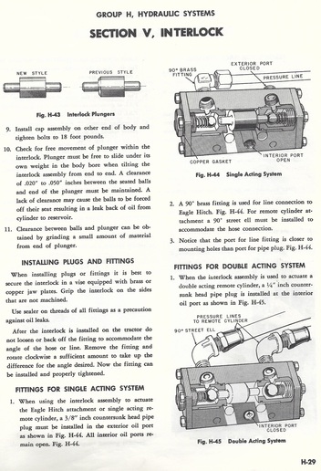

Can you scan and post that back pressure instruction, I am not very up on COM tractors. I believe that method
is for a remotes where you would tee into the DA interlock connection with a pressure gauge will show pump
pressure on one stroke and back pressure on the return stroke. It's not going to be the same back pressure as
the SA Eagle hitch would develop dropping by gravity as opposed to remote DA cylinder being pushed on one side
by pump pressure and measuring psi on the return side.
This is the function of the interlock when the control valve is stroked to lower the EH. The back plug has
pressure on it but it is pump pressure. Otherwise there is no pressure on that back plug unless the interlock
spool leaks on raise which again would be pump pressure. Pressure would not show on the back plug in neutral
position unless the control valve spool leaked pump pressure up there. I may be missing something but I looked

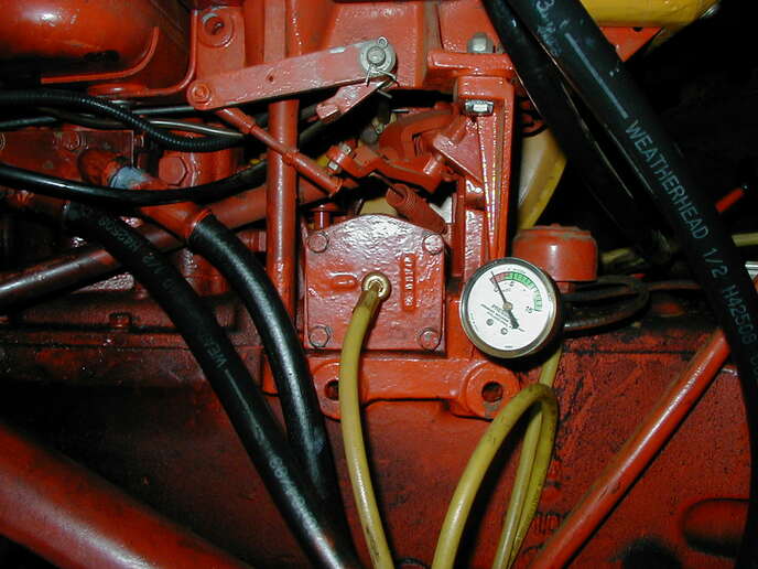

To check pressure to the EH you would tap in a gauge at the plug on top of the rock shaft cover adjacent to the
oil inlet fitting. That would give you back pressure during the EH drop but I am not sure it would be of any
use to determine back pressure in the control valve and manifold circulation circuit. That is a good question

mEl It is just the opposite, plug in for DA, plug out for SA. look at the SA interlock function that I have
been posting when the control valve has been stroked to lower the EH port C needs to be unplugged so the pump
can circulate oil to avoid going in relief. Port C is the one that is plugged for DA interlock.
I have twice in this thread discussed moving the EH function to the upper control valve and pulling the DA
interlock on that control valve to remove the plug.

Joe, Mel,
I went out this morning to give it another try. Before I started to remove any parts, I started the tractor to watch what is going on with the spool and bellcrank. Believe it or not it was working better than the day before. I can raise the eagle hitch now and it will stay in place. But when I lower the hitch, then but the lever in the center position to stop, it will still slowly drift down. I'm going to call it good enough for now. At least it will be good enough to run a loader with, I hope. I want to that you for all your help. I learned a lot about the hydraulic control on this tractor.
mEl this the page from a 300/300B service manual. Probably have to zoom to read it.
This is what I wrote earlier about back press building up in the manifold/filter and backing up into the interlock, dumping the hydraulic lock on the EH piston. Is this possible? That is why I want him to check the return oil filer clean and if that doesn't work to shift the EH function to the upper control valve and take the plug out of port C on that interlock.
Checking back pressure on the EH interlock in that manual posted by L.Fure is true, however, what they are measuring is pump back pressure not the EH circuit back pressure. The instruction is just poorly written.

Lets clear up this misconception re checking EH back pressure. Checking back pressure on the EH interlock
in that manual is true, however, what they are measuring is pump back pressure not the EH circuit back
pressure. The instruction is just poorly written. I am not certain of the stated pressures as I haven't
done that check.
This is the interlock function when lowering the EH. If you connect a gauge to port BB (plugged)as
described in that manual, you will be reading pump back pressure not EH back pressure. The pump back
pressure will be changed with the distance to the left that the spool moves to uncover port C to circulate
pump pressure. Pump pressure is balanced by the check ball spring, that is why they indicate to add another
gasket under the cap that will weaken spring pressure causing the spool to move further to the left pushing
the ball check further off its seat and the EH drops faster. The pump pressure also drops lower because
more of port C is uncovered. Take a good look at how the interlock functions and you will understand.

It all started out with the sloppy linkage. I had replaced the roll pins in the bellcranks to remedy that problem. What I found was a cobbled together bellcrank that operated the remote control valve, which was real sloppy. The bellcrank for the eagle hitch had worn roll pins. After I renewed the pins I found that the shaft had play in it on the bellcrank side. That's when I put out a request for replacement cranks and bellcranks. Jean Claude Marlaeu supplied me with a used set. Not knowing what the cranks were supposed to look like I figured the ones from JC were correct. When I tried to install them I discovered that the cranks wouldn't work on my 600B, but the bellcranks were good replacements. Now here's where it gets a little foggy for me. I can't remember whether I had replaced the bellcranks before or after the trip to town to fill the gas cans, and either put the tractor in the garage to replace the bellcranks and cranks after the trip, or if I had something else in mind when I put the tractor in the garage. I'm thinking that I could make the eagle hitch work after I replaced the roll pins, but didn't like the slop that remained from the cobbled up remotes bellcrank, and crank rod/shaft slop. When I discovered that the cranks from JC wouldn't work I went ahead and switched out the bellcranks with the goober welded cranks. I think that's when I discovered I had a new problem, the sinking eagle hitch. I should add that the cranks from JC were made of aluminum, and the steel shafts were too long. The cranks that are on the tractor are flat stock goober welded onto the steel shafts. The ones from JC didn't have any slop on the bellcrank end, but were too long. I thought about cutting the shaft to the right length then drill a new hole in the shaft for the bellcrank. I decided against that in fear of not drilling the hole straight enough for the roll pin. I would need a v-block and drill press to do it right, neither of which I have. And I knew that I would really make a mess if I used a 3/8" drill to make the hole.
Would it help if I made a short video of the bellcrank action? I'll see if I can do something like that.

I couldn't make a decent video. But I did take some pictures.
I did a quick and found a seller for each lever but YT automatically deleted my response on this Modern View Forum but it posted on the Classic View Forum. While this thread is open, go to the top of this page and click on Classic View in the box will take you to this thread in Classic View.
Joe

There is no neutral detent in the spool for the ball. The reason for removing the spring and ball is so the spring on the front under the cap can center the spool. The ball in detents is to hold the spool in position until the linkage is operated.
The EH is operated by hand or the quadrant lever. If you haven't already done so, take the quadrant rod off the EH lever and see if that makes any difference. If it does we can go through the steps to adjust that rod.
If nothing else we can remove the control valve ball and spring and see if the spool spring up front is strong enough to center the spool. The linkage is pretty heavy but with all the slop you have maybe it can put it in neutral.

I'll try it after removing the detent ball and spring. But every break down picture I've seen has those parts in them. When I did have the detent ball and spring out to check the spring, I stroked the spool and it seemed to me that the spring at the end of the spool was too strong. But what do I know? I'm the one coming to you for help. Like I said, I'll give it a try with 5he engine running this time.
I'll try to find the ball & spring description in a manual. I know I read it somewhere but my memory isn't so great on where that was.
Joe
OK let's look at this a little closer.
The 500B tractors have a G13983 control valve with the detent spring and ball and G13985 control valve w/o the spring and ball. That's the only difference between the two valves You could that the spring and ball out of the G13983 and put it in the G13985 and it and it would now be a G13983.
600B uses a G14140 control valve. There is no parts break down on the 600B page but there is for the same G14140 control valve on the 400B page. There may be some difference in the G13983 valve and the G14140 valve but they both show a detent ball and spring.
Your link shows the EH control valve and linkage but it is too dark to really see much so I looked at the control valve and linkage for the remotes. This pic is pretty dark too but there is a definitely a plug on the side. Both of 600B control valves are listed as G14140 same as the one above.
Pull the plug on the bottom control Valve and see if there is a spring and ball in there, if not pull the plug on the top control valve and see if there is one there.
