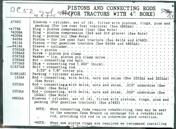

As the attachment shows, from my D series parts manual sn#5600000 and up (52 and up), Case offered also a 4” bore all fuel set and a gasoline set of sleeves and pistons.
Up until 1952 Case had offered only the 3 7/8 bore cast iron pistons. I might be wrong but I am 95% sure the 4” sets were aluminum pistons. Aluminum pistons need more "cold clearance" with the sleeves than cast iron pistons need.

Thank you for that info. From a visual inspection through the covers on the oil pan it looks like all 4 pistons are scuffed pretty bad and they appear to be aluminum. I'll keep you updated when I tear it down and try to post some pics.
You probably know that some Company offered a sleeve and aluminum piston set with 4.062 bore. Maybe M & W? Two of my DCs had the 4.062 bore. The sleeves were thin at the bottom. Maybe somewhere around .08 thick if I remember correct.
Maybe your tractor has 4.062 sleeves and 4.000 pistons. I think that would be prone to scuffing and have a lot of slap. Either diameter rings could probably be installed and probably work without tearing up something.
