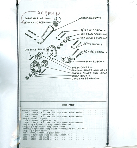

Third Party Image
Third Party Image

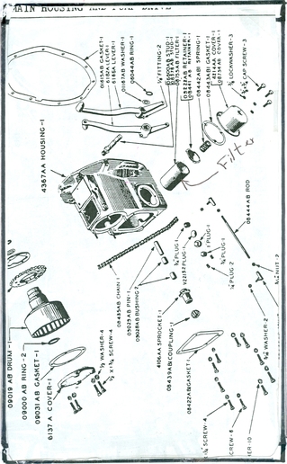

There is an inlet screen buried deep as shown. A filter on the side is accessible as shown.
If the top gasket only has a break or two, Just dab the breaks with Permatex or equivalent when you reassemble.
All this mechanical experience you are getting will look good on a Resume if you choose to look for a job where mechanical skills are useful.

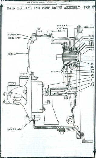

Third Party Image
Third Party Image

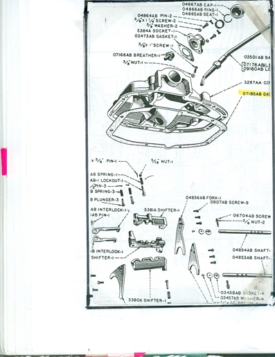

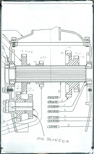

Is the gear that dropped the one I labeled OIL SLINGER? Did the reverse idler also drop down? You might try fishing for them with a piece of heavy wire and an appropriate hook bent on the end.
The other picture is the hyd oil and pump compartment. You may be lucky and still have some oil in it because it is separate from the trans oil. This DC has live hydraulics so the pump runs when the engine runs. Hopefully no water here. I believe this compartment has to be removed in order to remove the PTO and hyd pump drive shaft that is in the way of getting other assemblies removed out the top.
Ways that water gets into the transmission include.---- Rain water runs down the exposed steering shaft and seeps thru the support bearing. 2. If the boot on the gear shift lever is damaged or gone, rain runs down the level and goes into the transmission,

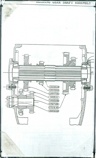

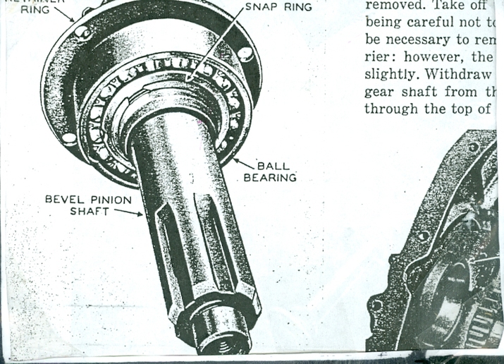

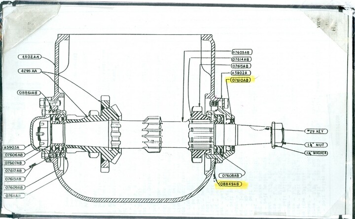

Third Party Image
Third Party Image
Third Party Image
Third Party Image

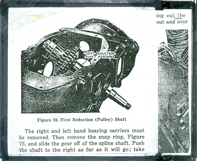

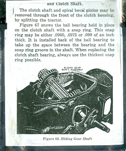

Hopefully the pictures will give you clues
Remove the belt pulley
The tractor has to be split to remove the transmission input shaft and the input bevel gear. See picture
The shaft with sliding gears has to be removed. See ;picture
The inner snap ring has to be removed that holds the gear closest to the pulley. See parts call out assembly (O7614AB)
Remove the bearing supports on both ends of the shaft.
Remove the lower shaft assembly. See picture.

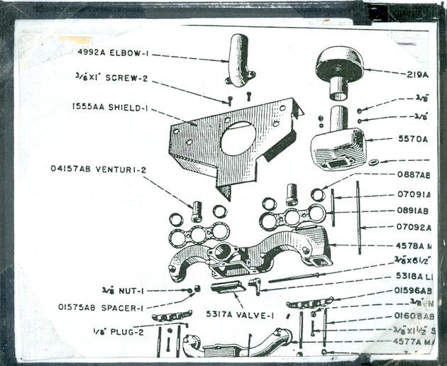

Third Party Image
The picture indicates the original exhaust elbow. You are extremely lucky if the two bolts or studs are reusable. Its tedious to drill out the rusted bolts and end up with reusable threads. Been there and done that!!!!!
