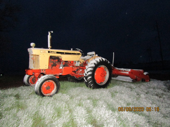

Case Nutty 1660
05-09-2020 05:29:09
Report to Moderator
 Re: Case W3 backhoe cylinder seals? in reply to tractorsam, 05-08-2020 02:01:39
This morning we have a bit of snow, I may have today hopefully Third Party Image

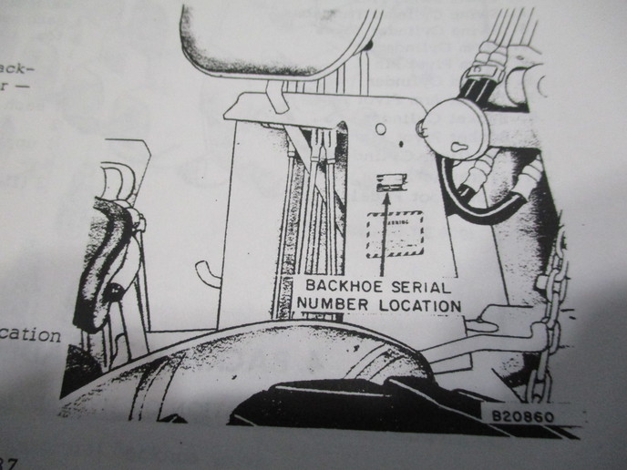

Case Nutty 1660
05-04-2020 17:29:25
Report to Moderator
 Re: Case W3 backhoe cylinder seals? in reply to tractorsam, 05-01-2020 14:57:23
I forgot to ask is there a model stamped on the backhoe serial tag?
[Log in to Reply]  [No Email]
tractorsam
05-05-2020 02:28:42
Report to Moderator
 Re: Case W3 backhoe cylinder seals? in reply to Case Nutty 1660, 05-04-2020 17:29:25
No model that Iíve been able to see but not sure where I should be looking. The tag on the loader indicates a 42. The hoe has the boom cylinder inside the boom and the barrels are mounted to the pivoting casting at the base of the boom and the rods are pinned on the stationary base on the back of the tractor. Hopefully that narrows it down. Thanks, Sam
Case Nutty 1660
05-05-2020 04:48:07
Report to Moderator
 Re: Case W3 backhoe cylinder seals? in reply to tractorsam, 05-05-2020 02:28:42
All backhoes of that era had that boom cylinder in the boom design,, the serial tag was on the main boom LH side can you post me some shots of the backhoe unit,, swing cylinder areas will help but I need shots of the whole unit also,, the boom cylinder on yours is it held together with tie rods or does the gland screw in the rod end,, I think you should have a model 31 but have not dug through all of my pallets of parts book binders to find a W-3 parts,, backhoes are listed seperatly in parts books,, I also could use the serial # off the backhoe tag if its still there
