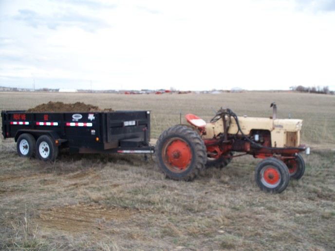

Is the only differences between 211b and 311b tractors the smaller engine in the 211?

This was the picture of the tractor advertised as a 311b. I had to attach the url link. I couldn't get pictures to work

The reason I asked is the 311b sold yesterday had the dash as pictured on the 211b in Tractor data (individual guages). The parts catalog seems to indicate the 311b had the cluster like the original 300. Like a dope I didn't look for a serial plate. I thought the tractor looked smaller than the 300 I looked at some time ago but old man memories are not reliable.

Your statements are correct, the 211 has individual gauges and a smaller engine.

So the tractor sold was mis-identified. Was it lighter built than the 311 or the same except for the engine?
