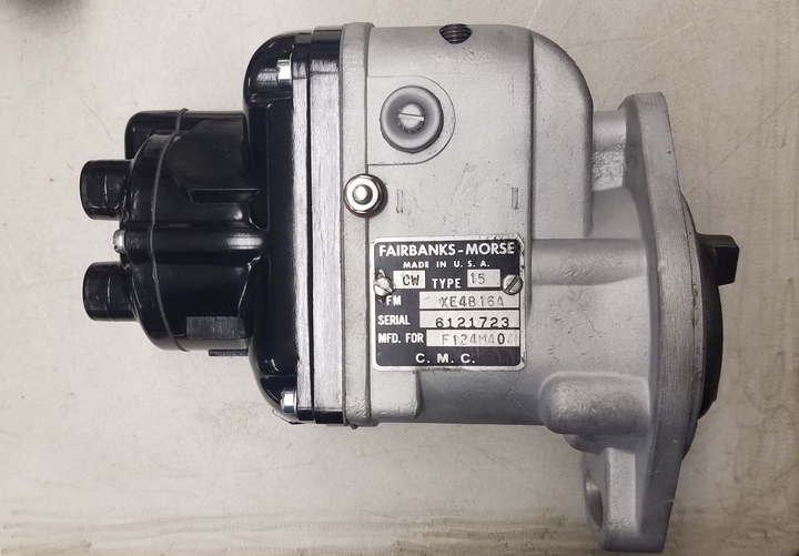

Ken Christopherson
02-02-2020 10:59:10
Report to Moderator
 Re: DC mag/distributor conversion in reply to L.Fure, 01-28-2020 06:14:21
Yessir. I work on the side for a great mentor of mine. Google rebuiltmags (.) com and it will come up. Rudy is a great guy, and rebuilds them for people all over the world!
Photos are of just some magnetos and carburetors I have done while working with him.
