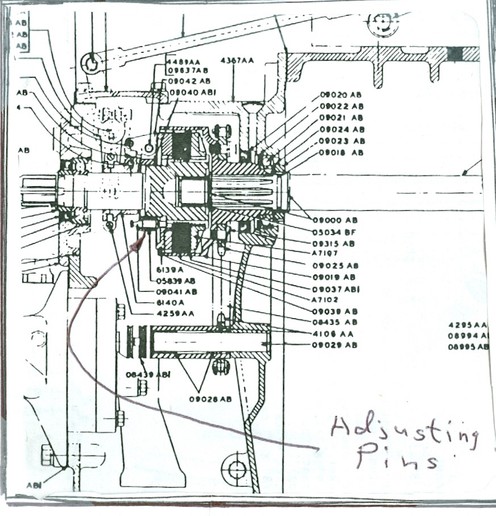

How strong is the hydraulic system on the later DC's? On the live pto clutch were there any issues, was it weak? (its not a big unit) size wise. On any I been around they did not use the hydraulics much just for very simple things. Mine has 3 PTH so I want to use it. Will be a little while before I get to that as I am concentrating on the engine now.

There are two main enemies of the D series PTO clutch and one main enemy of the hydraulic system---
1. Slippage caused by the PTO clutch adjusted too loose
2. Improper PTO start-up procedure
3. For the hydraulics, it is dirt in the unfiltered hydraulic oil.
As we know, the PTO clutch needs to handle momentary peak loads without slippage--- such as when using a bush hog in brush. Also, most live PTO clutches on many tractors are not designed to handle repeated high torque start-up loads at high engine RPMs.
The PTO clutch needs to be adjusted so there is a strong ?detent feel? when the lever engages. The D series engine has good low torque so it will engage most PTO loads at low RPM. The live PTO clutch should last a long time.
