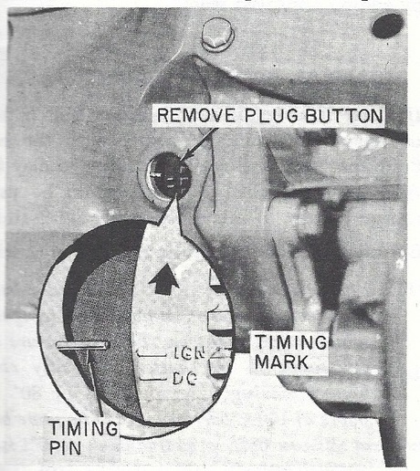

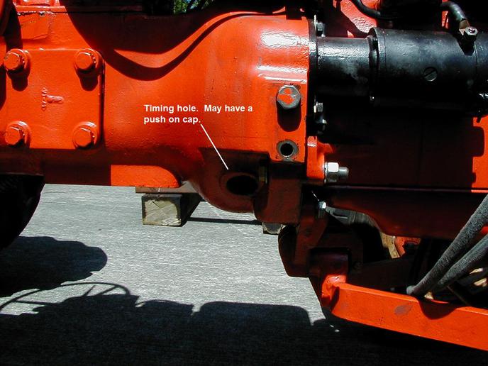

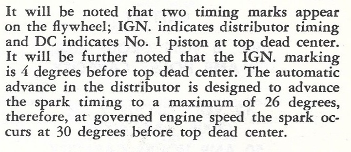

Buddy has a G310W tractor that has a gas engine. He was trying to time it and he assumed his dry manual clutch bell housing (torque tube) had a hole like my Case diesel 530 to align timing marks. He couldnt find a hole or plug he could unscrew or remove. He managed to time it using #1 spark plug hole on compression stroke yet he would like to fine tune it. Any tips would be appreciated. He also would like clarification on what the G and W stand for. I suggested General Purpose and he figures the W stands for Wide rear wheel base or wide tires.

Joe (Wa)
10-21-2019 11:19:30
Report to Moderator
 Re: G310W Tractor timing question in reply to Cariboo4x4, 10-21-2019 08:36:43
These pics for 300 - 300B series tractors, don't know if it is the same as yours.
Joe
Third Party Image
Third Party Image
Third Party Image
