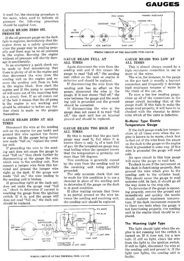

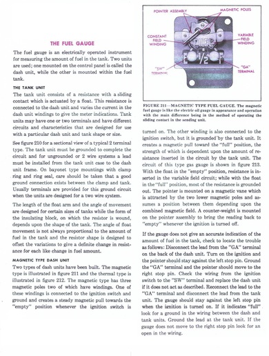

1. I have a bad fuel gauge (A21496) and a spare where if I check on continuity, they both show open. I assume this means that they are no good. Is there anybody in the country that can repair them?
