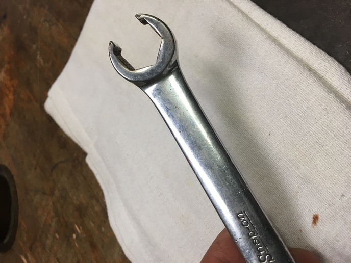

I'm trying to remove a Roosa Master injector pump from my 431 diesel and am down to the 3rd bolt near the motor block. Any tools, techniques, or tips anyone could offer for getting that nut off of the stud? The closed end 9/16" wrench I'm using doesn't get down onto the nut squarely.
Thanks,
Lee Brown
May I suggest this wrench from snap on or with a grinder modify an existing craftsman wrench of that size. All you really want are little bites at a time until the nut loosens. CM
The three bolt pump mounts a custom made wrench works best. I have an old 9/16 open end wrench welded up just for the Case, JD, and Oliver/Waukesha engines for the back stud nut. Even Snap On right angle wrench won't work well on that stud nut. Mine is about 80 degrees to the handle..
I used to hate cutting or bending a wrench to work in a one or two time application but I've learned that it can save a ton of frustration to just make a tool that works. Saves on band aids and curse jar money as well. You can take that money you saved and buy a new wrench to replace the one you modified.
1/4" drive 9/16" socket works perfect on 730 + larger tractors. Not sure on the little ones, but worth a shot. 1/4" extension is small enough to get in there when 3/8 is to big.
regular 9/16 - 5/8 curved starter wrench ground for easy clearance, mine was a flea market find and has served me well for many years and dozens of those pump removals and re-installs.
