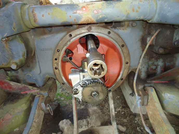

Hello, I need to remove the PTO cover from a case 990 selectamatic. Other than the warning light housing on the bottom of the cover, is there any other parts/ connections that I need to disconnect? I don't have any manuals. Would appreciate any advice on precautions I need to be aware of. Thanks, Steve.
Sir, I'm going good to have a look-see at the hydraulic pump. Also I am concerned about the plumbing from pump to valve and lift cylinder. I hope the lines aren't split. Have you ever replaced any of those components? If the suction loss is coming from a busted line, does that require removing the valve block in order to replace them? I have no oil flow coming to the chamber that the selector switch ( TCU,depth, height ) sits on top of. I know there has been frozen water/Hyd fluid mixture in the system. Thanks for any info or insight. Steve
There is nothing special you need to disconnect. I'm attaching photos of what is inside. "I don't have any manuals" - I am pretty sure I gave you this link in one of your prior posts. It contains a free pdf of the I&T manual for your tractor. See also the following link which contains free pdfs of most all of the factory David Brown manuals that apply to your tractor:

If you pull that pump and then go to put one back in, be sure you read the part in the manual about making sure the gears mesh right. If you don't you WILL ship (at least) a tooth and get to take it all apart again.
Theres a pretty fair chance your pump is just worn. IIRC it's an aluminum casting with steel gears. They wear out if the oil isn't changed.
I've got it down to only one bolt is holding the cover. I must go get a couple of bolts to make long - guide studs, before I go further. Are you referring to the manual - David Brown - Two speed power take off. 8 pages. Where it refers to engagement of the high speed gear and alignment? On page 3.
I don't know what page it's on. I'm talking about when you put the hyd pump in you NEED to bump the engine over to get the gears to mesh fully before you tighten things up.

Well, I haven't posted any pictures, but you're welcome. The pto cover isn't that heavy, I don't think it weighs 100lbs even. I know I took mine off and put it back on alone and I'm pretty wimpy these days. You have to turn the the engine a bit, just a "bump" or 2 or the gears won't mesh and you'll bust one. Just make sure the fuel rod is in the "OFF" position and bump it, then check the pump and you'll see if it's ready to go in all the way or not.
Hi Steve, I'm the guy that was working on the bare ground using pallets to keep everything out of the mud. I removed the pto cover and put it back on by myself. I eased it down to the ground by hand. I used a floor jack to help me lift it back up into position. I put down a piece of plywood on top of the pallet so I could roll the floor jack close to the rear end of the tractor. I forgot to bump the engine as I was pushing it on. Maybe I broke a tooth, maybe I didn't. I'll find out when I finally get the thing started. Hopefully in the next couple of weeks. Good luck with yours.

So I finally got to the pump. The pump has a crack all the way across one side of the impeller housing. I suppose that the same ( water/ freezing ) incident that buckled the suction pipe ( on the pickup end ), and also bulged the bottom of the filter housing , was when all of the damage occurred.
I would ask all or any of you , that now knowing what I have found as far as the freezing of the filter housing, suction pipe, and pump being cracked, what other parts would warrant close inspection? What are the chances that the hard line ( internal hydraulic fluid pipes ) are also split or busted ? The portions of the lines that I can see do not appear to be bulged out any where. Thanks, Steve
