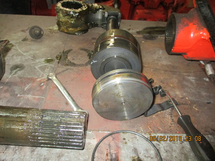

Good Afternoon, I thought that my summer project was up and running but now I have another problem. My three-point on my 1969 Case 440 will not go down. I recently rebuilt the power steering cylinders and now they work like a charm. I didn't know if that had something to do with it. I think the three-point was working when I parked it this fall. Would like some direction on this problem. Thanks

No the power steering is a separate system with it's own pump and controls. The next thing that I would do is to check all the mechanical linkage from lever to the DOM control valve which is under the RH of the seat. If everything there seams OK, then I would loosen the line from the DOM valve to the 3pt housing and see if arms drop and oil flows from 3pt housing. If so, you will have to remove the little cover on the DOM valve and make sure that all the plungers and check balls are free. Be careful when removing the cover. parts can fall out.--

He said he redid the steering cylinders. That tells me he has a later tractor with a Draft-0-Matic 3pt hitch. The arms on them will drop regardless of the engine running. It sounds to me that the hold spool is stuck in the DOM valve.------Loren

OK, in that case (no pun intended) you have a mechanical problem in the rockshaft housing. Piston seals rusted into cylinder bore, or the arms were lifted too high, and the donkey dong is out of place and holding the arms up. If this is the case DO NOT try to force the arms down.
In the pic., the donkey dong that I refer to is the large round rod above the piston in the pic. attached to the lifting bellcrank arm at the top. The donkey dong is not attached to the piston. The back of the piston is an inverted cone and the donkey dong just centers itself into the back of the piston.
It is becoming evident that you may have to remove the rockshaft housing and determine what is wrong. Removing the rockshaft housing is pretty straight forward and takes less than an hour. Keep us posted on your progress.------Loren
PS just an after thought: Is there any extra movement in the rockshaft above where it is?? Can you lift the arms up further by hand????? If soo, lift them by hand and let them drop a couple times. That may dislodge the donkey dong if it is out of place or free up the piston if it is stuck. Worth a try and nothing to loose.
UPDATE: Thank both of you for your help. Yesterday (In fustration) I pickup the 3 point arms and "dropped" them. The arms went down some so
I pushed down on the arm and they stared going down. I started the tractor and the arms went up but not down. So I repeated the process and
sure enought the arms went down. So it must have fixed itself. Thanks again for all your help and I will be sure to reach out with my
progress of this project.
