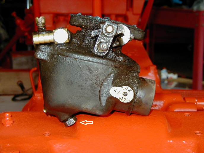

My Case 311 RN Sat for a year until I got around to fixing the PTO. Now I am trying to get it running again, and the carburetor is giving problems. Had it cleaned and rebuilt, new float and complete kit installed, put it back on last night. Still doesn't start. I know it is getting gas to the carb, and I can get it to start and run if I keep spraying starter fluid into it, so the electrical isn't the problem. Any suggestions? At my whit's end, really though rebuilding the carburetor would solve my problems.

Pull the plug on the carb bottom to check gas flow to the bowl, should be a steady stream.

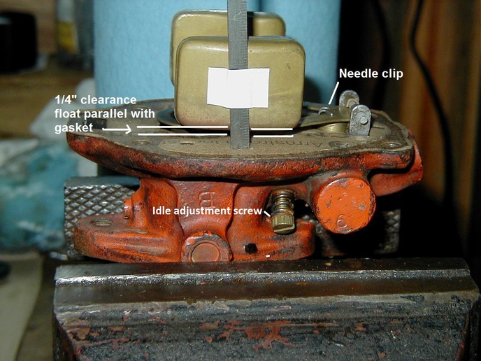

Check float setting with the gasket in place.

Thanks Longcases! By chance you would not have a picture of the jet you are talking about or know of a manual that shows it? The guy that rebuilt it said he cleaned it with glass beads and solution in an ultra sonic tank.
Those needle clips dont fit some float seats i discovered.put new kit in my 411b set float thought all was well.it sat 2 days.wouldnt start black fuel smoke.pulled air cleaner hose lots if gas ran out.took carberator apart ,the clip touches edge of brass seat not letting it shut gas off.tossed it and left gas on all day.air cleaner hose left loose no drips,touched key fired right up
Kinda the basics, but they get me all the time; what's the setting of the idle and main jets? Governer and choke hooked up correct? I usually test the needle and seat by putting my lips on the fuel inlet barb and blowing, raising and lowering the floats so I can feel where it is and isn't allowing flow. I have a barb 1/8" fitting I put on the bowl drain and then put a clear hose on the barb and a plug on the other end. Loop the hose over the carb and then pull the plug and it will show you where the fuel level is.
