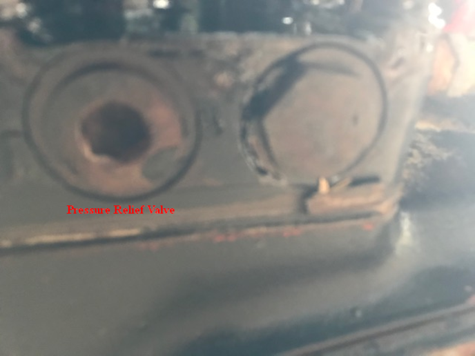

Last week I was brush hogging with the Case 495 and it became really difficult to steer, but the front end loader and the rear lift still worked. I replaced the hydraulic filter thinking that would improve the steering. But after changing the filter I now have no hydraulics at all - no steering, no front end loader, no rear hydraulics, nothing at all. The level for the hydraulic oil is full.
I tried bleeding the lines as the service manual instructed - I tried turning the wheels (they barely moved at all), raising the rear lift (did not lift at all), at 1500rpm for 3 minutes - nothing improved.
A neighbor suggested I clean the pressure relief valve that is found under the MCV - he thought this valve might be stuck open. I have posted a couple of picture of what I believe is this valve at the bottom of the MCV.
Here are my questions:
1. Are there additional line bleeding techniques that I could try?
2. What tool do you use to remove the valve that I have shown under the MCV?
3. What troubleshooting techniques can I apply to determine what could be wrong?
Any help or advice would be helpful!

My brother has 4 or 5 of these tractors and most
have some issues. The ones with the most
problems also have no brakes working. I told him
many times that with these tractors built in
Doncaster England, use one common hydraulic oil
for steering, hydraulic loaders and 3 pth and brakes.
And the hydraulic oil gets hot, and not all hydraulic
oil is able to take high temperatures over a long
period of time. And some hydraulic oil doesn?t have
additives necessary to keep the hot oil from eating
up rubber components, seals , brake parts etc . But
my brother is older and wiser than I , and he would
just buy the cheapest hydraulic oil he could pour
into the tractors. So my thinking is your oil has not
been of high enough quality, or if you have been
fateful and always used IH Hytran, you may have
diluted the hydraulic oil over time by using remote
cylinders that are sometimes used by other tractors.
So my thoughts are oil has started to break down
seals etc . And this stuff is now floating through the
system and bits are sticking in valves and controls.
Is this a CaseIH 495 ? If so .What kind of hydraulic

We are currently using the Hydraulic oil that we bought at TSC - we should try to use the specified oil made for the tractor that you have mentioned.
