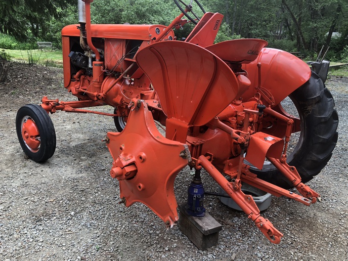

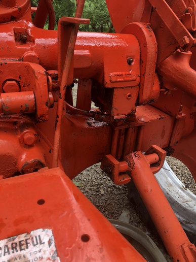

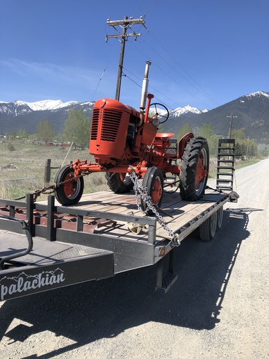

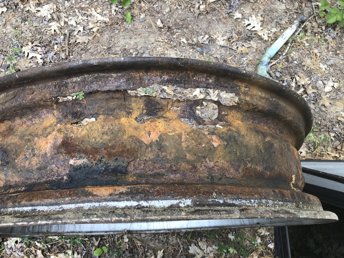

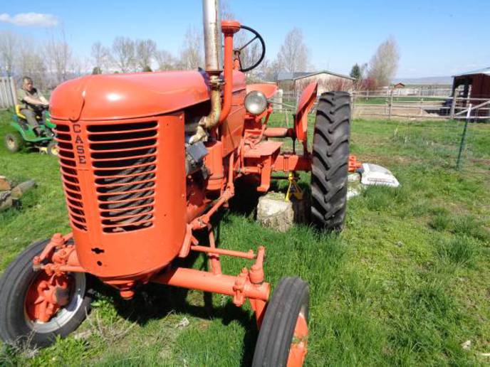

Got. The VAC home from Eastern Oregon. Needs some TLC. One rear rim shot, hydraulic leak and misc stuff. Needs a battery box, Iíll make one. Need to clean up wiring. Needs new muffler. Fixed hand throttle, it. Would only bring it up to about h half throttle. Lots of little things, but itís a pretty nice tractor. Runs good.

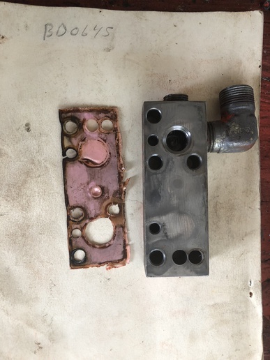

The original gasket was lead. I used to throw them away. Regular bulk 1/32" oil gasket material. A light coat of spray Copper Coat, let dry to touch. Been many years don't know what is available now. Gasket p/n nr in my VA parts book VT5153, wrote in a newer nr A30630. I don't remember ever ordering a gasket, don't know if that p/n is lead or not.

Got a gasket coming from John Saeli
