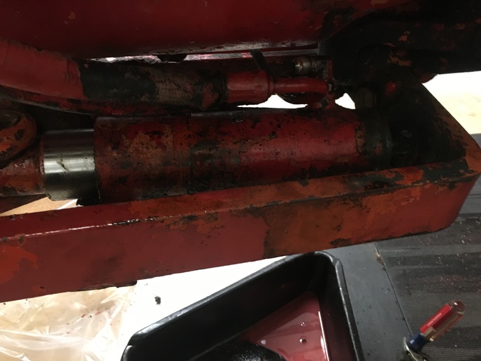

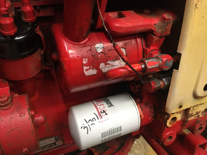

I am still working out issues on a Power steering pump #A36559 on my late model 430 . I have sought out many Archive articles on this pump,

I would just replace it myself,, L.Fure posted a link to a very reasonably priced replacement,, here is the parts breakdown though if you still need it, to me they are junk when worn out as they are normally ran out of oil and damaged
ps pump parts link
At that price, one would surely be better off with a replacement. I am somewhat embarrassed to say after several attempts to bleed The system, I loaded the 430 with a winch on my trailer and brought it home. I started her up and lined it up to the shop door, where the pump just decided to work. With that said, the left cylinder started leaking. I got the cylinder out this morning and will be ordering parts for that. Fellows thanks so much for all the information. It?s nice to know there?s pumps available.CM
