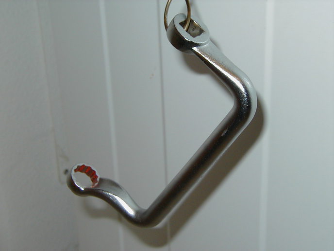

I have a Case 320 Terratrac that needed the top end overhauled. I had the head sent to reputable engine shop and it was resurfaced and had new valves, guides etc installed.
I installed new liners and Piston heads / rings. I cleaned the surface of the block and checked for defects and level etc. I also checked the liners for proper protrusion all around before installing the head.
I torqued the head in sequence of the manual to the correct specs as best as possible. I had a hell of a time getting on a few of the nuts with the crows foot and torque wrench without it wanting to slip. Clearance there is terrible not a fan of that design at all. Stupidly I did not get new head studs.
I got it all buttoned up and went to start it and the starter with a tight engine showed its weakness so out with the starter and cleaned and installed new brushes.
Two questions here I filled the cooling system with water just in case for some reason I had to drain back out. I noticed on the carb side of the block slight moisture in two spots tiny drop of water. Prob a dumb question but I'm going to ask anyways.
Should I removed the head and get new studs and nuts ? Will this have ruined my head gasket and will I need another ? Would this seal itself once the engine was fired for the first time from heat and expansion ? Also I did not use any type of gasket sealer on the head or gasket before installing. The book didn't call for it should I have ?
Water level in rad didn't drop, I also check the oil and cracked the drain plug to make sure my liners were not leaking I also before putting the pan on filled the cooling system to ensure no leaks around liners.
I did the valve lash according to the book and specs, gaped the plugs and the points, did the timing on D.C. 1342. It wouldn't fire. I checked the plugs for fuel and spark they were drier than I expected and spark did seem a little weak to me. I am going to compression check the cylinders now after the rebuild this I didn't do I took for granted everything would be great. It gets frustrating after all the time, cash and money spent to be back to troubleshooting. I know I just got to get back to the basics and start ruling things out one at a time, just figuered I would look for any tips, advise or possible abuse from my oversight on head studs.
My gut tells me to take the head off and get new studs and redo it all but maybe it can be saved from this point. Thanks for the input

pkreuter
05-31-2017 10:13:47
Report to Moderator
 Re: G148 Head rebuild and questions. in reply to jandmoutdoors, 05-31-2017 06:08:52
When I did the head on my D I found a wrench like this on ebay. Worked perfectly.
Link
Paul K.
[Log in to Reply]  [No Email]
Joe (Wa)
05-31-2017 07:32:14
Report to Moderator
third party image
I've not replaced studs and nuts either but weak, overstretched studs can be a problem. I would put that on the back burner for now.
I would go with John's retorque. In lieu of the proper torque extension lose the crowsfoot and use a box end extension on the side nuts. Review the torque info at the link. Run the engine to op temp and than retorque.
If still leaking, inspect the head gasket closely. Flaws evolving the top deck and head can show up on the gasket where it is not compressed evenly. New studs, nuts and gasket. I use dry gasket, some like sealers like copper coat.
Compression check on new, unseated rings is meaningless, a waste of time.
Joe

Joe (Wa)
05-31-2017 10:43:43
Report to Moderator
 Re: G148 Head rebuild and questions. in reply to jandmoutdoors, 05-31-2017 09:42:00
third party image
pkreuter's ebay tool will work fine, you need a 11/16" box end. Original tool looks like the pic.
Whatever tool you decide on, if there is an extension other than 90 degs or directly vertical to the center of the fastener head, you need to compensate for leverage. The link I posted above will calculate the correct input torque for you.
Joe
jandmoutdoors
05-31-2017 12:14:16
Report to Moderator
 Re: G148 Head rebuild and questions. in reply to Joe (Wa), 05-31-2017 10:43:43
Awesome, thanks for clearing that up too !!! I was told a long time ago not sure where that when torquing extensions can play a factor. It's is quite possible I don't have them torqued enough as well.
