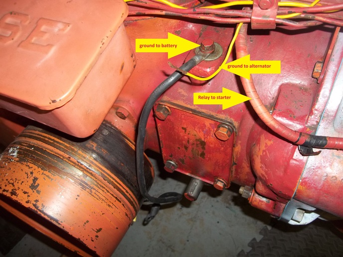

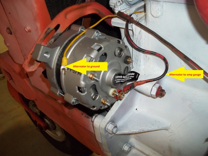

The wiring was never right on this tractor can anyone help steer me right the pressure switch was not connected and the rest you can see in the pictures. Note: No head or tail lights to hook up. Id be thankful for any insight I have no clue about wiring so keep it simple
Thanks Byron

rvirgil_KS
05-07-2017 21:25:46
Report to Moderator
 Re: Help on Wiring case SC 1952 in reply to Bhunt, 05-07-2017 18:05:45
That's the common Delco
Get a plug with short pigtails for the 2 pin edge connector
Loop #2 down to output stud, output stud to ammeter
Connect #1 through your oil pressure switch to output (coil) side of ignition switch
Alternator should ground through the mount so get a good clean contact there and you shouldn't need the extra ground wire
Install battery negative to ground

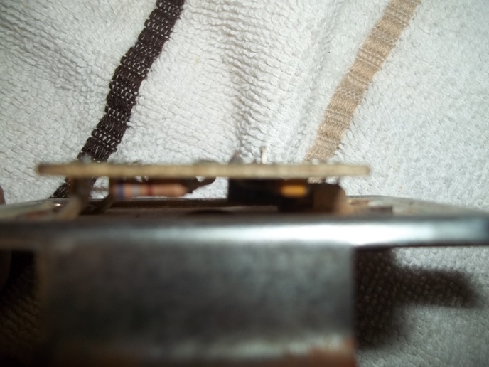

Bhunt
05-06-2017 23:19:37
Report to Moderator
 Re: Help on Wiring case SC 1952 in reply to Bhunt, 05-06-2017 18:40:39
This was bolted to the alternator with one bolt I believe. No idea what it is. It was not hooked up its got 8.53 ohms resistance maybe someone knows
Thanks Byron

rvirgil_KS
05-07-2017 05:48:02
Report to Moderator
 Re: Help on Wiring case SC 1952 in reply to Bhunt, 05-06-2017 23:19:37
Looks like a cut out for a generator. Cut in (connected) when generator output voltage reached a preset level above battery voltage and cut out (disconnected) when generator voltage dropped below battery voltage
The "regulating" was done manually through a resistor on the light switch. Not used with and alternator

rvirgil_KS
05-06-2017 19:19:24
Report to Moderator
From what I can see from your pictures your wiring is electrically correct.
What brand alternator are you using? Doesn't look like the commonly used Delco. Is it a one wire configuration? Alternator case should ground through the mount, so do alternator instructions call for an extra ground wire?
One possibility for the oil pressure switch is that it was used to turn on a previous Delco 3 wire alternator. One side of pressure switch to switched side of on/off switch, and other side of pressure switch to #1 pin of 2 pin plug on alternator. Makes no difference which way the pressure switch is connected.
With out some form of isolation (switch, indicator light, resistor, or diode) there may be feed back from #1 pin of alternator to output of ignition switch to coil that will cause the engine to continue to run when the ignition switch is turned off.
Your alternator should be negative ground and -- post on coil should go to distributor.
[Log in to Reply]  [No Email]
