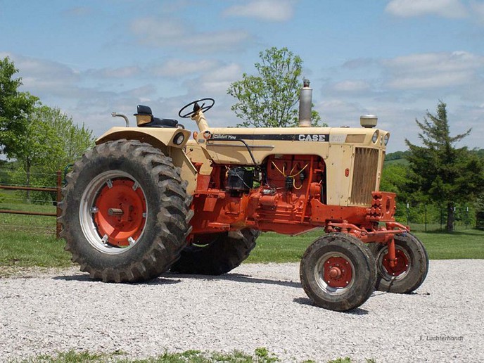

I've got a Case 830 CK that is having trouble with the top left hydraulic remote. The tractor has 2 remotes on top and 2 on the bottom. The inner lever controls the 2 remotes on the bottom. Moving the lever rearward pressurized the lower right coupling, moving the inner lever forward pressurizes the lower left.
The lower right operates as it should, but the lower left if I move the lever as it should be moved, loads up that side and seems to over pressurize and the cylinder won't move. But if I move it very slowly it will move the cylinder at a very slow rate. Pick up the pace and it loads up again. I have to wait a few seconds after it loads up for it to operate from either right or left. Any suggestions on what to look into?

New hydraulic lines and the beast....I found that they wouldn't post due to size. resized and here they are
third party image
third party image

01-18-2015 15:46:17
Report to Moderator
 Re: Case 830CK Dual Remotes Trouble in reply to tluchterhandt, 01-18-2015 15:19:05
First thing I would do is check/change your male and female couplings. One or both may not be opening enough to allow full flow.
Loren
