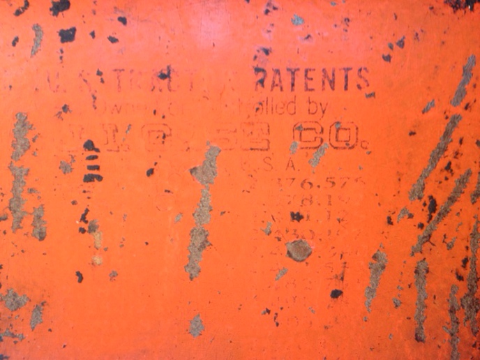

Also while degreasing and pressure washing I came across this decal on the bottom right side of the block near the magneto.
Anyone reproduce these??

The patent decal did not come in the set that I ordered. Does anyone know where I could get one?
Matt
